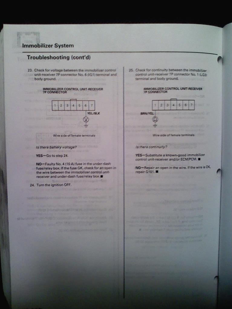

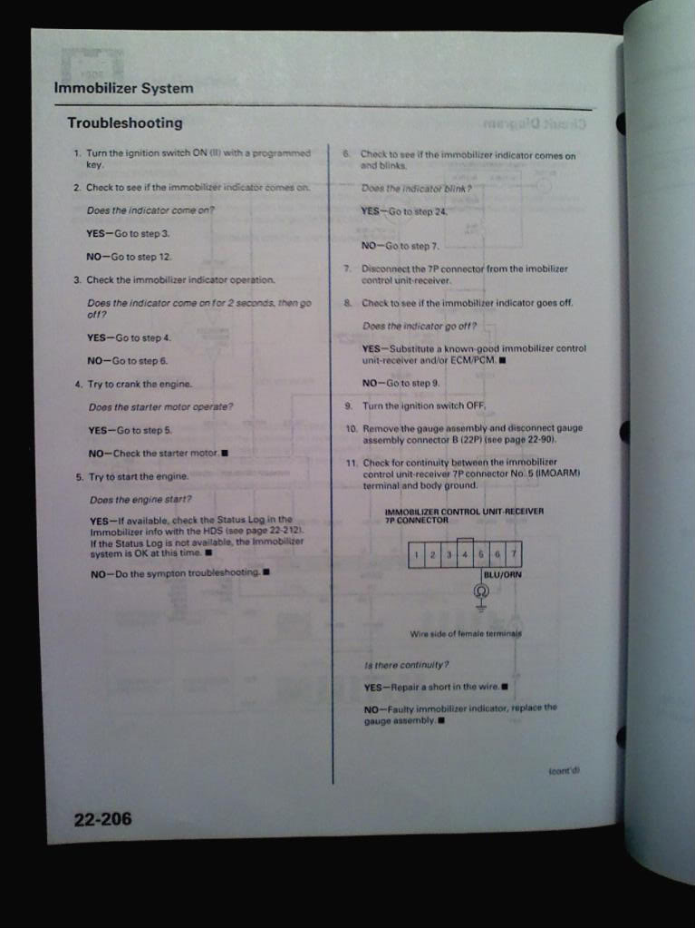

The service manual says you need a Honda scan tool but, there are some things you can do before you take it to the dealer.
Worst comes to worst, replace the immobilizer. It's #14: http://www.bkhondaparts.com/billkay/...itch=&hidIrno=
(Sorry about the fuzzy pics, phone cam)
