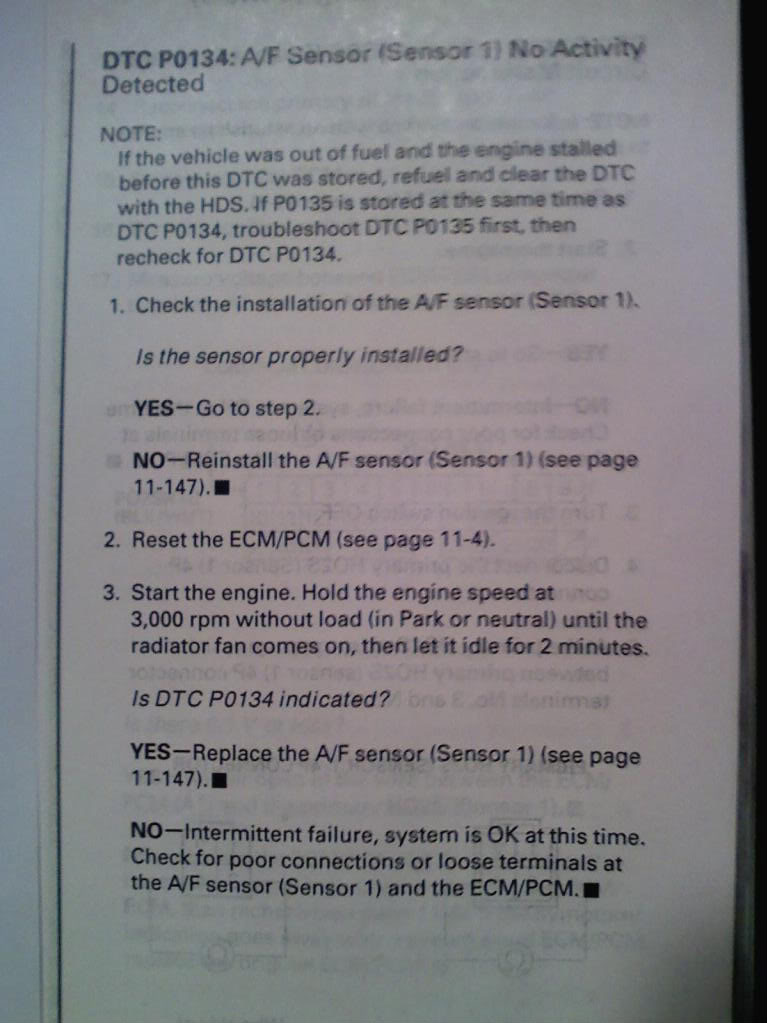

Sorry about the fuzzy pic, phone cam.
P0134:

Thanks for the info on the A/F sensor lazlong! I'll give that a try.
