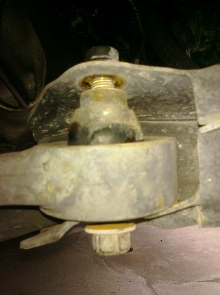

These were the best I could get, the first is the LCA bolt and bushing and the last is the ball joint obviously. I've been beating on the separator with no joy at all. I've started removing the rotor and all of that so I can get that ball joint out of the more easily but I haven't had the time to get everything off as of yet.

ball joint - if you using the fork type, forget them. go to harbor freight, they had a real separator.
they look like this one.
http://www.amazon.com/OTC-6297-BALL-.../dp/B0015PN010
bushing - are the top nut rotating with the bolt? if so, the welds broke and you need to hold the nut as well.

The nut on the top is not spinning, but the metal piece from inside the bushing is. It is big and tough to get a hold of with tools to keep in in place. One i get the wheel off I am just going to beat down on the control arm with a hammer until it separates from the ball joint. That is if i can actually get the other side of the control arm off.

non, non, get a rental separator in the autozone - they are easier to use.
after taht, you can take the bushing with the sleeve off easier. first the ball joint.

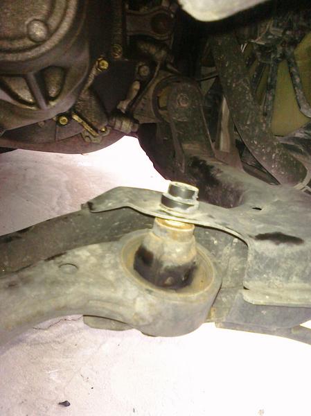

OK so this ball joint just isn't coming out so I decided to cut the ball joint once I got the 2 bushing for the LCA out and then took the steering knuckle off. I finally got the stuck bolt out with a lot of time, WD-40 and a good old fashioned hammer. I had to use a half inch breaker bar to get the lower bolt off of the steering knuckle but that finally came off. After I did the same for the top bolt the nut came off but the bolt will not come out. I have tried prying it with a hammer, using WD-40, smacking it with a hammer, smacking with a 4lbs dead blow. It just doesn't want to budge much past .5 inches out. Anyone know a trick? Maybe I am missing something. I have posted a picture of my latest problem.

Jack up the knuckle to relieve pressure on that bolt.

I got the knuckle out and since the ball joint wouldn't come loose I used a hacksaw to cut it from the lca and then pushing the rest of it out using an air hammer at work. I have the new ball joint in the freezer right now so hopefully that will help me hammer it in the knuckle in a couple hours.

This project is becoming my nemesis. The freezing trick didn't work so I tried a c clamp and that didnt work. Then I went to autozone and used their ball joint kit and the things is too big to hit the ball joint straight on and get it in. The part that bolts on to the strut juts out which eventually slides the clamp off. Im thinking of heating the knuckle with a torch if I can't get this thing on and hopefully it will expand enough to drop in there. Any ideas?

Thanks for all the help guys! I have it almost all the way back together. I got the ball joint pressed with 1 1/4" sockets, a vice and a 3 lbs dead blow hammer. I messed up some of the hardware threads getting them out when they were seized so I need to get that but once that is all acquired it should finish relatively quickly. Again thanks for all the help and I look forward to any help in the future!

with the knuckle out, it could have been easier to take it and the ball joint to a shop and ask them to press it in - much less labor costs...
But your way is the least costly except for the tools...

Next time, if you ever have to do a ball joint again, the autozone one fits, you just have to use it backwards, thats what i did and it worked very well and went in straight. If I had one I could show you how I did it, but it sounds like you've got it in already.
