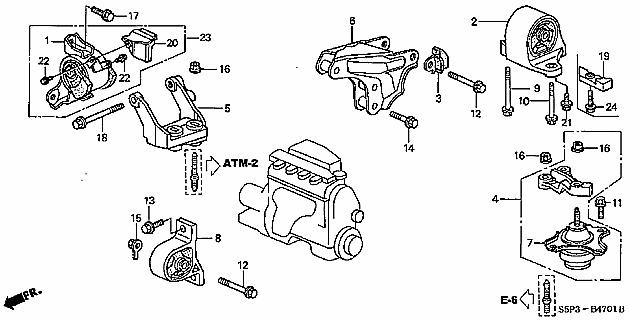

not sure if this is the right thread to post this in but im having a problem with my engine mount the drivers side engine mount on a 02 honda ex one bolt is striped the bolt i am talking about is the one that goes to the engine if you look at the pic i uploaded it called e-6 bolt now just the bottom half is striped now my question is can i glue that in some how and what would you recommend me to glue it with or what the best way to fix my problem?????

No, you can't glue your bolts in place, maybe you could epoxy it in place with JB Weld, but that just a temporary fix not the proper way to repair a stripped thread.
To do it properly either have a heli-coil put in or re-tap it.
