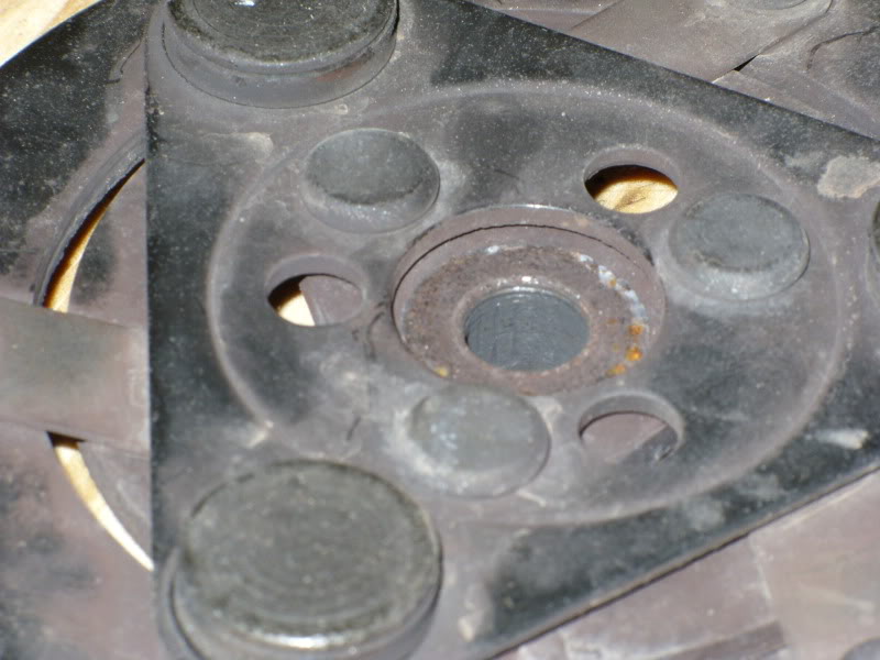

My clutch just flew off too. Luckily it landed up against the fender and I still have it. But looking at it, it appears that there should be inner teeth but they are stripped:
And it looks like the teeth on the compressor post are worn down a bit too:
Are there inner teeth on the clutch? Should a new clutch still work on the worn compressor post, or is a replacement compressor in my near future? I was excited when I found the clutch, but it may not be the blessing I was hoping for.
Now another thought: it appears the bolt loosened and the clutch was able to freewheel on the post, stripping off the inner teeth (if there are inner teeth). If I just replace the bolt and torque on the post, then is a new clutch necessary? I can add "check torque of AC clutch bolt" to my list of routine maintenance a lot cheaper than buying a new clutch or compressor.

^As long a nut can thread on the shaft you can try to replace the clutch on the pulley assembly. I was told to check that it was still intact beforehand. But you also need to install shims to get the proper spacing, just a reminder. I think I still have the instructions somewhere with the shim sizes.

My concern is that I may not be able to torque the nut on tight because how can I hold the post still? So the teeth of the clutch seem to be required to mesh with the splines on the post. I think I'm gonna try to replace the clutch to get one with full teeth, and I believe the clutch comes with a shim kit.

Yeah after closer inspection of your photo the splines are rounded out, your best bet is to buy the pulley/clutch set. My A/C clutch is probably on the side of the freeway lol.

I got a full clutch kit and went to replace. I couldn't get the outer shim off to pull the pulley, so I just installed the new outer plate. I put in shims and not enough gap, removed, more shims, not enough gap, changed shims, too much gap, changed shims, then within spec. I used a pry bar to hold the pulley still to torque the new nut on the post. After putting everything back together after replacing the head gasket, started up and had a revving issue. Turned on the AC and it was nice and cold. Found that the rev issue was from not installing the PCV hose to the back of the head and life is good again!
