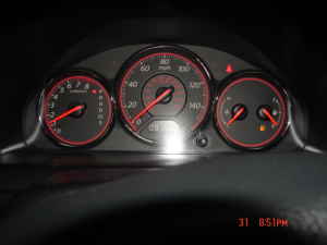

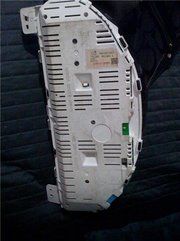

Hi. Can anyone tell me if this cluster is a Nippon Seiki, and if it will fit into a 2003 civic dx, even if the factory cluster doesn't have a Tachometer.

What is it coming out of?

Also, will it fit and what do I have to do to make it work are 2 different questions.

I think it came from a LX model

I don't know which year came from, it was on ebay, but it says it will fit 2003,2004 and 2005 civix LX.

From what we can tell, it came out of a 03-05 civic lx or ex coupe, automatic.
If you dont have a tach wire in your wire harness, I'm sure you'll be able to add it- lots of ppl add tachs, its probably as simple as plugging the clip in, or at most, running a wire from the ecu area to your gauge cluster. Search for adding a tach on the site to see what involved, I know a lotta ppl have swaped clusters so they could have a tach.
It'll fit in your car, so dont worry about that. The connectors will plug right in as well. The only thing is you might have to repin a few wires (pretty easy) look up 01hondercivic's 03-05 gauge cluster swap thread, he has a link to a video.
