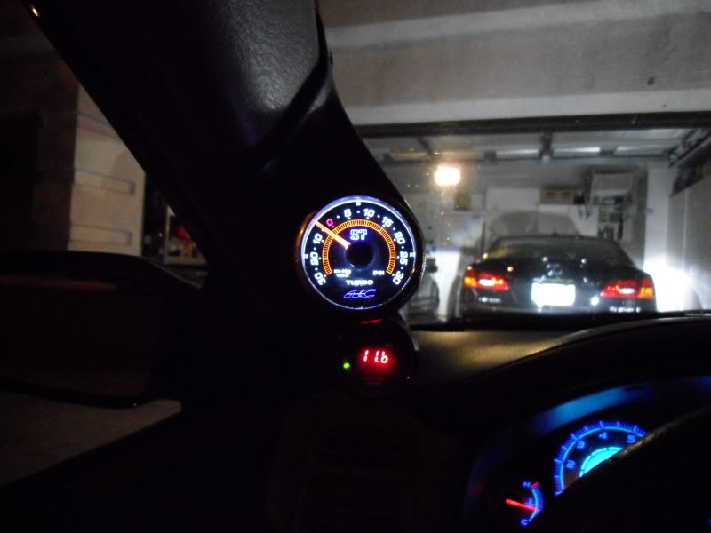

My boost gauge reads abnormally high for idle (which is lower than normal, the idle, that is) and my car is running rich as hell to compensate for it (i'm assuming).. anyone got anything that may help? Had I not had the boost gauge, I would have thought that replacing the MAP sensor would fix it, but like I said, my manifold vacuum actually does read higher than what I'm used to. Idle's a bit rough and noticeable power is gone from the bottom end, and quite possibly the whole RPM band.

Manifold vacuum reading about 2"-5" at idle with a 10.0-12.0 A/F ratio

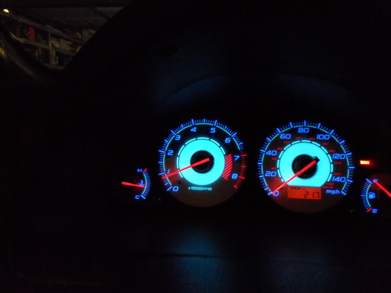

Idle's lower than normal, actually has stalled itself out a few times

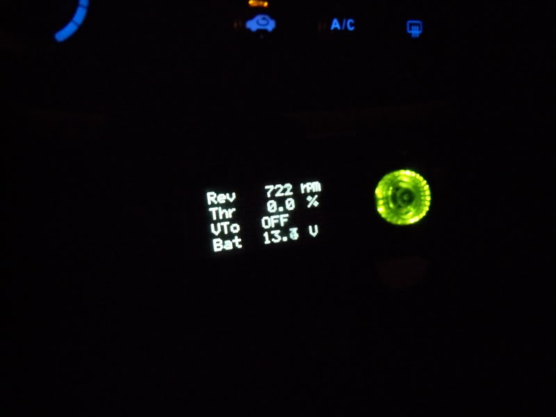

Just showing that engine RPMs is about 700 at idle from a normal 1000-ish. VAFC-II doesn't control anything.. It just monitors RPM, throttle position, and battery voltage, now.. effectively disconnected anything it possibly could have controlled.

hrmm.. fair enough on the "low" idle.. but it dips down hella low when I get off the gas, and it has stalled itself out twice
