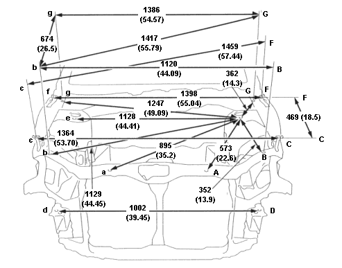

The last three items are to make a homemade tram gauge. Basically, in the shop manual you'll find measurements to various points on the car's frame and steel support panels from various other points on the car. For example:
These measurements are great, but they are measurements from level. If you remember your high-school geometry, if you just lay your tape measure on point A and point B, unless they are totally level, your measurement will be of the hypotenuse of a right triangle - which never ever equals the length of one of the straight sides.
Therefore, you stick the dowel rods into the hole points on the frame, making sure they are vertical with the level, tape in place. Take the long piece of wood, put it between the dowel rods, make sure it is horizontally level. Mark it on-center with the dowel rods at 90 degrees and take THAT as the measurement. Look at the tram gauge picture. You'll see what I mean.

6: Assuming your car is mechanically sound, it is measurement time. You need to make sure your frame rails are the correct distance apart. Check the shop manual measurement point, and make sure that the rails are exactly that far apart from center of hole to center of hole. I think the tolerance is like 1-2 mm. If the rails are out of spec, STOP and take it to a body shop. They'll need to pull the frame. You don't want to mess with it. If the rails aren't level (assuming your shop floor is level) STOP and go to a body shop. If they are different lengths out from each other, STOP and go to a body shop. Your frame is the foundation of your car, and if it is out of whack it is definitely beyond your capabilities, and it means everything else is out of whack as well.
6: Make a diagram of all the measurement points listed in the shop manual, and measure ALL of them with a tram gauge or your homemade measuring device. Compare numbers, and list the differentials.
If ANY points are more than about 1-2" out of spec, STOP. To fix the problem, you'd need to bend the steel so much that it would lose a lot of its strength and you should probably replace the whole bar. To replace components, you'd need to weld it. I don't know how to weld, and I sure as hell don't know how to keep the frame from twisting when working on it. Take it to a shop.
7: Everything suitably minor? Basically, you'll need to check the differences and pull the parts back to spec using directional force proportional to the impact. It helps to know and look at the angle of impact, as that is probably the angle you'll want to pull at.
8: Slide hammer time. Hook the working end of the slide hammer on the bent part, but DON'T start working straight at the point of impact. You want to work from the outside towards the center of the deformation. If you start at the center, you end up just stretching the metal and causing yourself major headaches when you can't figure out why the fenders are splaying.
Many semi-light strokes are better than a few leviathan ones. tap tap tap, check. tap tap tap, check. You want to angle the force to move the outsides of the part toward their final position, but you don't want them there quite yet. Use the final pull at the center to move things very slightly - by the time you work the center you should have pulled it decently close to where it should go.
Every time you change the position of the hammer from one area to another, use the tram gauge / improvised tool to measure your work - that way you can see how far each tap / force is getting you. You'll want to work the piece in a few sections, lightly, going back and forth to get the pull accurate enough. Hopefully you'll have some sort of symmetry on the undamaged part of the vehicle to work with to see where to aim.
