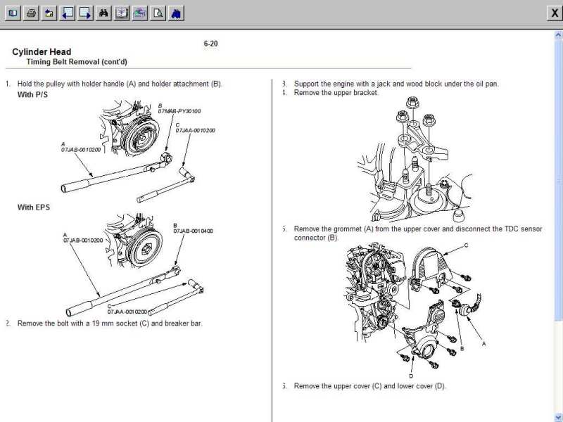

is there a thread on how to remove the crank pully

here is the book procedure. but im sure an impact gun will work
