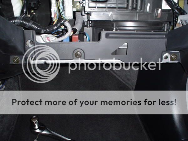

Is it hitting the metal bracket on the bottom? You may need to actually remove the bracket which holds the two relays. It's held on by four bolts I believe and comes out very easilly. The relays are on a seperate piece of metal that comes out easilly. After the steel bracket is out of the way you should be able to bend that wire out of the way enough to pull the ECU out. The plastic that sits in front of the steel bracket should just bend out of the way once the bracket is gone.
You can see the metal bracket behind the plastic in this picture:

Old May 15, 2011
mishima's Avatar
Joined: Oct 2010
Posts: 7
mishima is an unknown quantity at this point
Re: How do you remove the ECU???
Yes, the metal bracket has been removed. I'll try moving some of the wires and bending that plastic.
