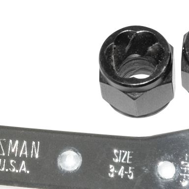

Craftsman Bolt out works!
I had a stripped oil drain bolt and nothing worked to get it off. I tried channel locks(after it was already stripped), vice grips, I even packed a socket with JB weld and let it sit on the bolt overnight. Finally I went to sears and bought a set of low profile bolt outs for 30 bucks. I was scared it wouldn't work with a completely roud nut. It took it off in about 5 seconds. I would highly recomend picking a set up to just have handy.

Excellent info. I just picked up the Canadian Tire version of the Bolt-Out (Mastercraft Extract-It) as I rounded one of the nuts on my catalytic converter trying to take my Magnaflow off. Hopefully I'll have time to try it this wknd.
