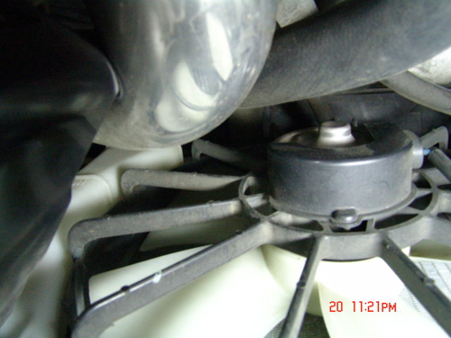

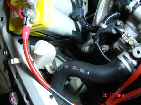

yeah theres an expansion tank right near the radiator see if thats full if not top it off with 50/50 mix of coolent and water or if you dont have coolent just ad some water and then chex for leakes on the ground.
in pic two there the expansion tank
in the firstpic theres min and max line if its to the min line fill it up to max then chex all your hoeses for leaks
