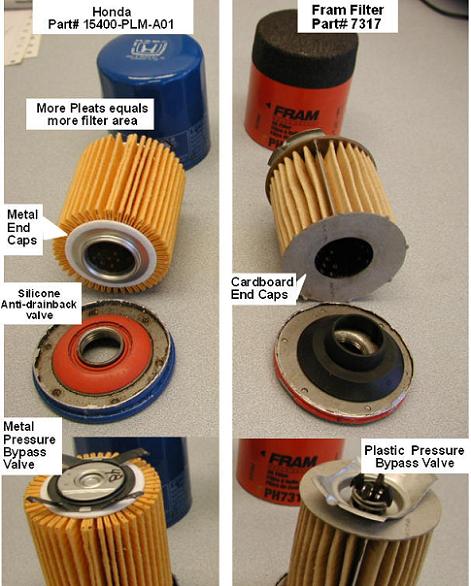

Here, a pic of Fram versus the Honda OEM filter. Keep in mind both use the same material for the actual filteration, and in other test, more has shown to be more effective.
The point is, a manufacture can demand better quality from a company, better than what the company sells to the public. Tire companies do the same, your OEM tires go through FAR more regorous inspections and test than the SAME exact tire you can go buy at the tire store. So not all things are equal.

maybe I should start using OEM filters now. Never really took it into consideration before.

are you sure that one isn't the honeywell version?
Remember, honda just switeched to fram as their oil filter supplier. Honda has several oil filter contracts.

Well, if you can get the buy 2 get one free they're not a bad deal. But if you pay the $4-5 for each one, there are better filters out there for the price. But I get them for a little under $3 a piece, so I think it's a good deal.

Honeywell = Fram (http://www.fram.com/about/findex.html)
But yes there are two main manufactures of Honda filters, that I believe is the Fram one. I'll check though.

This is incorrect. The Honeywell (Fram) Honda filter is p/n 15400-PLM-A02. The picture you posted with p/n 15400-PLM-A01 is a Filtech. A Honeywell Honda (Fram) filter is nearly identical to an off the shelf Fram.
http://theoildrop.server101.com/cgi/...=001428#000004
http://www.tegger.com/hondafaq/oilfi...r_comparo.html

This is another picture of a Honeywell Honda filter. If the can wasn't blue, you'd have a hard time telling it isn't an orange Fram filter.
http://elabfcsvrt.fdu.edu/bartsch/Pr...400PLMA02B.JPG

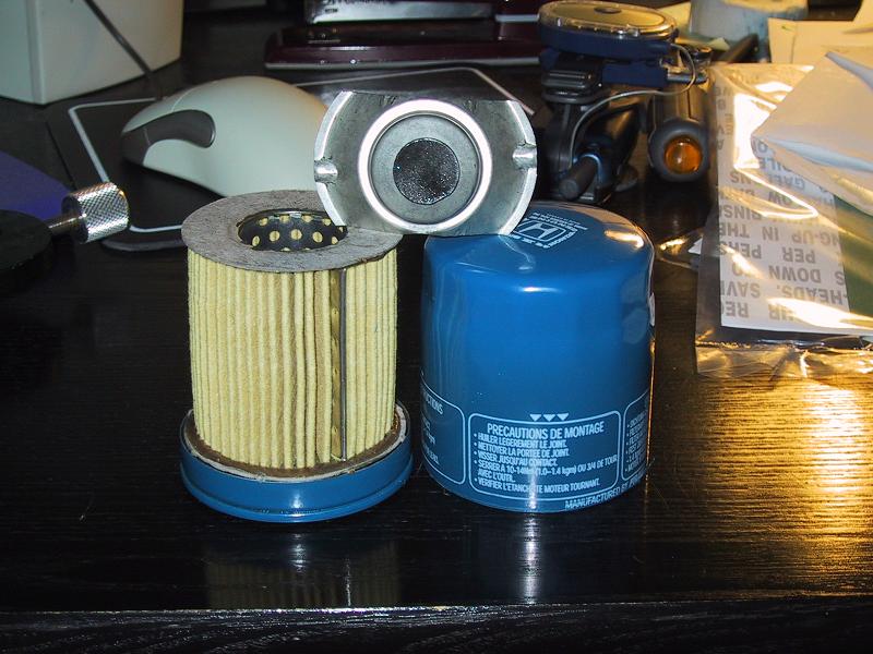

Take a look at the orange Fram pic that I posted and the cut away of the Honda OEM that is made by Fram that YOU posted (the second pic) this is the one most people buy. Notice a difference in the amount of filteration material? I would say the Honda one has more, but maybe I just can't see right
And yes the first one I posted is the Honda filter for a S2000, but I believe it fits on a Civic too.

ok, lets keep get this thread back to the original topic. It went from batteries to oil filters to tires. It was a nice argument, but I think the original poster wants to know more about which batteries are better.

^^^ yes. I already stated that just because a company makes a product for the masses, it isn't really the same product as they make for a manufacture. Secondly, I think he'll be okay with any battery that is fresh, like someone else stated, read the dates on the batterys and get the newest one you can find, this is probably more important thanwhat brand you buy.
