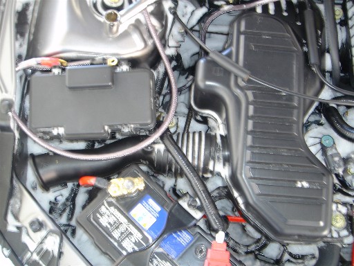

I got what I could but still plenty in there.
http://www.7thgencivic.com/forums/at...chmentid=46039

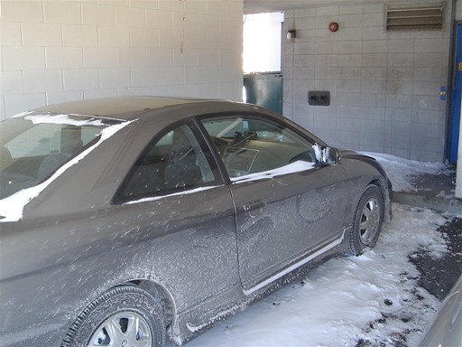

And this is my packing space, somehow the snow got blown all the way up the engine bay.
http://www.7thgencivic.com/forums/at...id=46041&stc=1

Here's a better shot.
http://www.7thgencivic.com/forums/at...id=46044&stc=1
http://www.7thgencivic.com/forums/at...id=46045&stc=1

WTF!!!

damn man...how the fvck did all that **** get in???......you wont get electricuited, fire it up and have ur alternator checked.

Blame it on the strong wind and the dam snow dust that was falling, also the wind tunnel parking space.

Damn! That car is frozen!! Even the exhaust pipe. It won't start until you open the exhaust pipe, and make sure there is no snow in the intake. It looks like it got packed in pretty bad. I've never seen this before. I'd suggest you get a block heater installed, and an optima yellow top. That should keep you running through any winter.

Oh, and that's no insurance claim. It's an inconvenience. Next time you park during a storm or blizard, put some kind of cap on your exhaust pipe. And do the block heater and battery. Sounds like you just need to beef up your car for severe conditions. This is common in germany as well. It could get so cold that we had to light a small fire under the oilpan of the diesel we had just to thaw it enough to turn over. Oh man. And everyone had extreme duty batteries. No biggie. Civics don't come that way stock.
