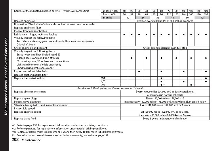

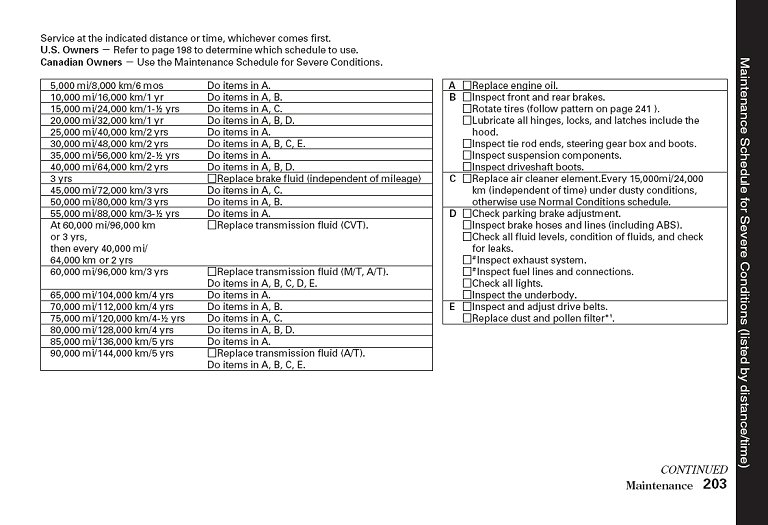

You can got to Honda's Owner Link page and download a copy of the Owner's Manual for free. Its a .PDF file and about 5MB in size. Here's the Severe Schedule...
that's nice, thank you..

Uh, no.. I think the above info should be enough.
