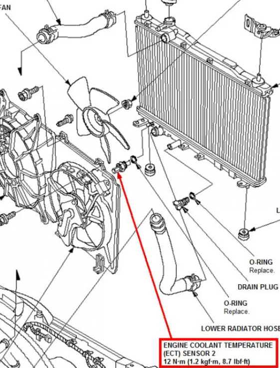

The wiring harness is completely gone. I assume that previous work on the front end resulted in some sloppy reassembly. I was planning on purchasing a new harness for a new sensor (lower as red arrow in diagram shows). Question, where does this lead terminate in the engine bay? I do not see any visible exposed wires but if I was able to know approx where the wire leads to in the engine that would be helpful to track down hopefully....Thank you
