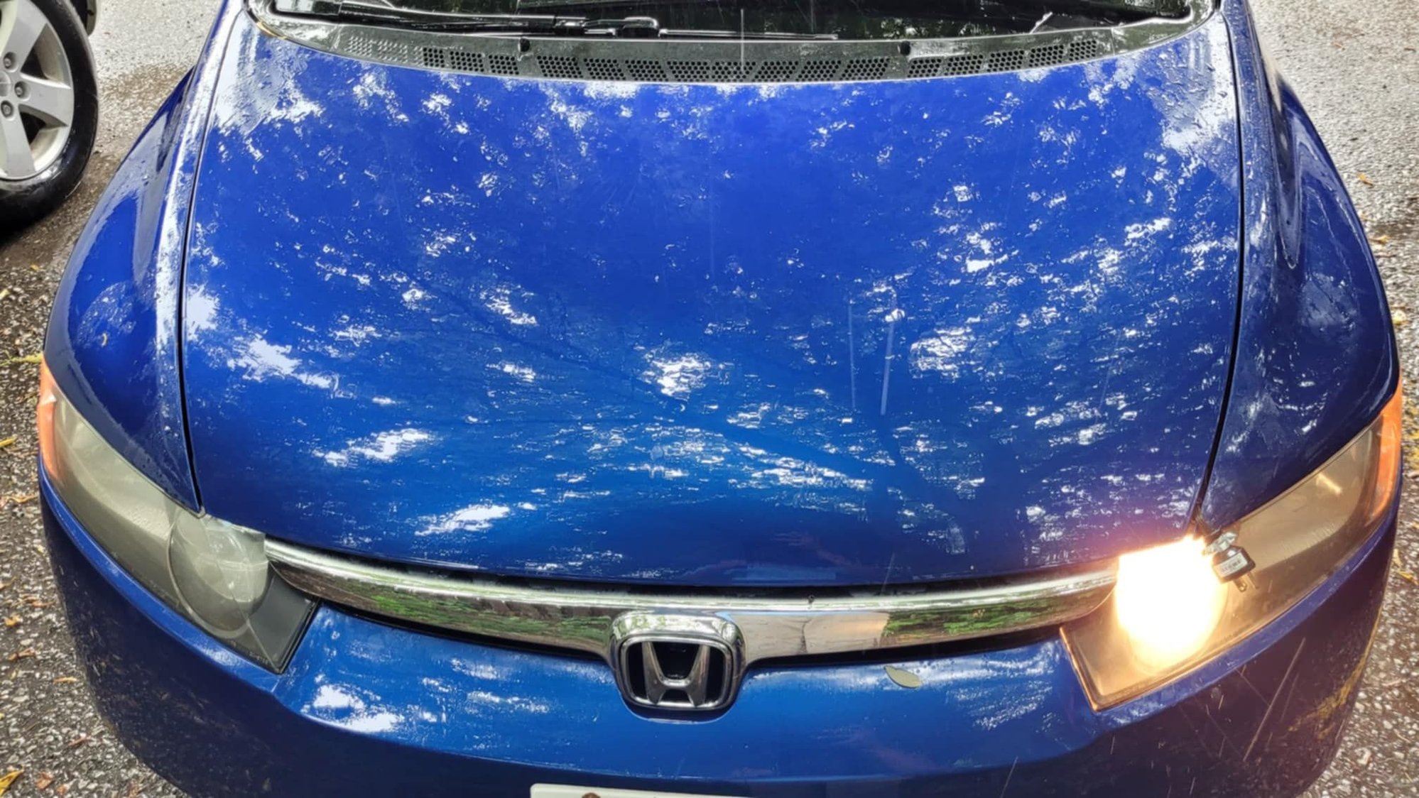

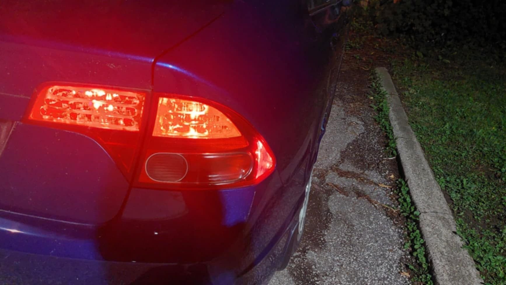

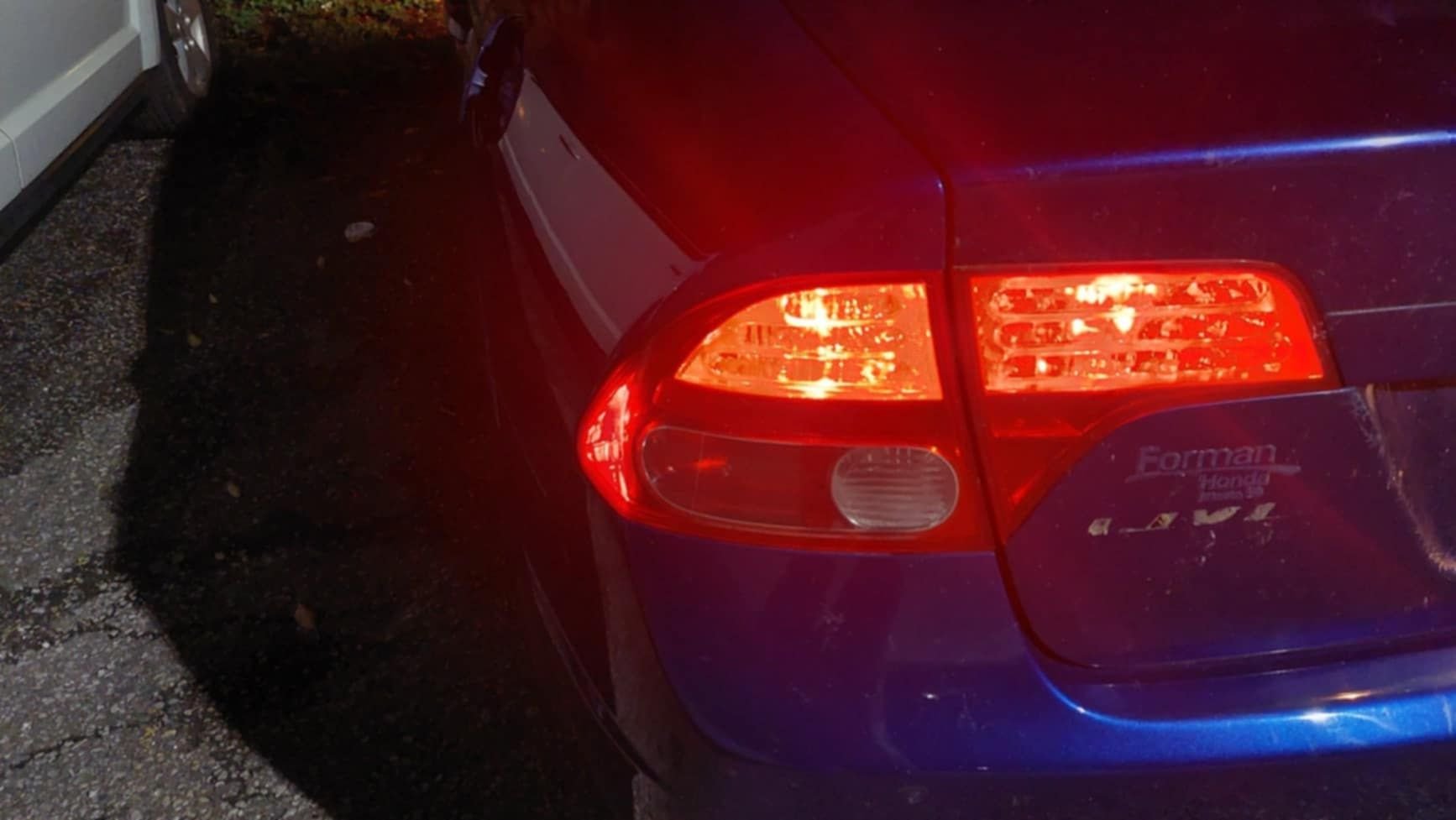

Hi. I am going for a safety inspection for my Honda civic 2007. So I am checking all my lights, back lights. It looks like all back light tail light lit up? Some parts of the red lights are not lit thats why asking.
And My headlight not working. how many light bulbs not working? I watched many youtube videos and they only shows replacing one head light (sylvania 9006). Just change one headlight (passenger side)? Could you please check how many lights not working and model please?

Tail lights look fine. You don't show brake lights or turn signals.
You'd have to turn on your low beams to know if they're working. Passenger side high beam not working. High beam is also used as DRL.

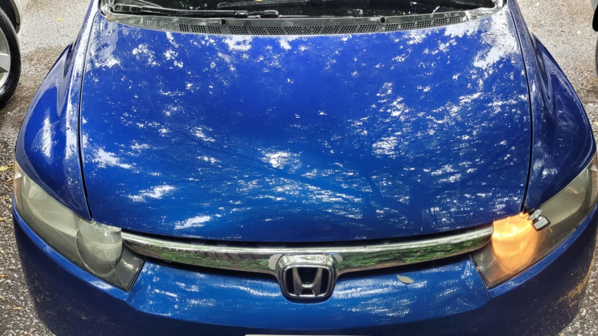

Hi. Thank you for replying.
So, on one pic it shows high beam another shows low beam. So how many lights here not working? 3 lights? Model please?

No, one pic shows the day running lights (DRL). The next shows high beam. DRL use the same bulb as the high beam, just with a lower voltage. It's clear the passenger side isn't working.
Low beams are the other large area that isn't lit up. You have to turn the headlights on. Unless they're both not working.

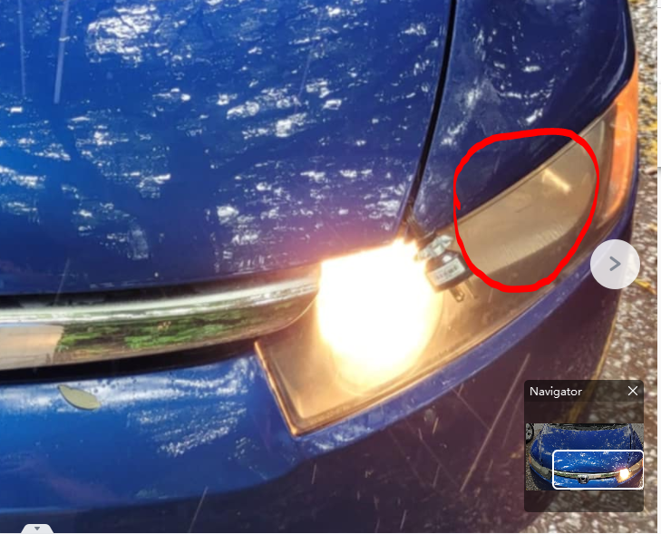

For my headlight I have only these two variation. High beam and DRL. Since DRL and high beam uses same light, so this light in red circle not working....I need new light? what it is called? you know the model number please?

That is your low beam, like I mentioned. Low beam is a 9006, high beam is a 9005. Again, make sure you have your headlights fully turned on. If you only have the parking lights turned on, the low beams will not come on.
