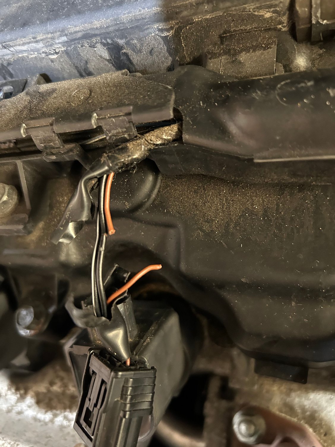

I found the problem. One wire on the 4th coil was totally broken and the one next to it had the wire partially exposed.

phew, that would be the cause, for sure!
