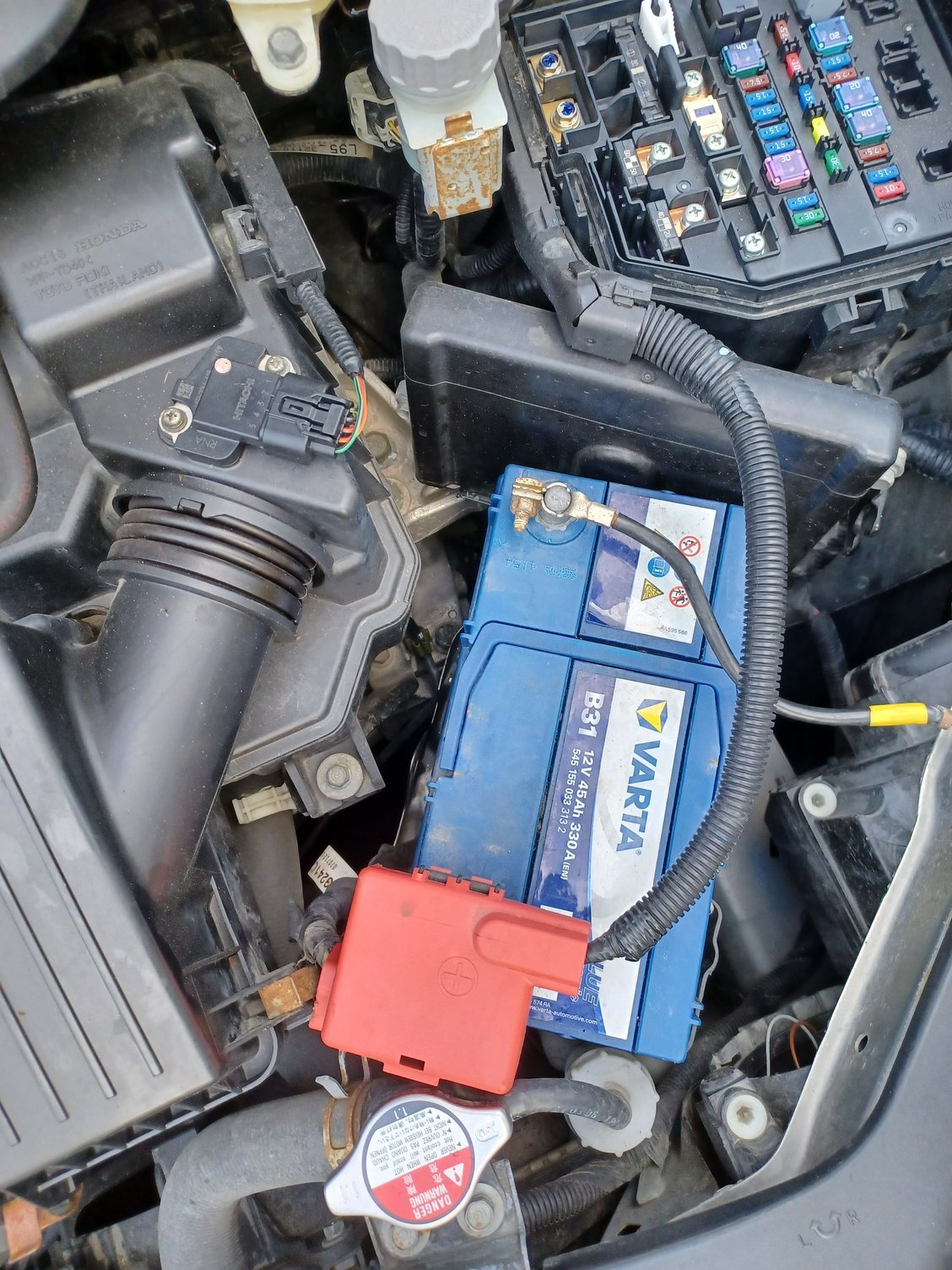

not sure, but it looks like this.
btw, I'm able to use the key system and there is light in the dashboard when I connect the key but the car won't start. Its weird that it have some juice left for electronic but won't start without me jumping it.
Radio and AC arent working though (when it's not jump started)

That sounds like a bad battery. I'd start there.
You can see a vague imprint of a sticker on the bottom right. It looks to have been removed. I'm guessing it's older than advertised.

Battery test showed 10v, when dead. Didn't measure when engine was running. What thing that worries me is the posture of the battery (look at picture). It's standing way too loose with no attachment hooking It. Could that be the reason for its short coming? Too much trauma etc etc?

Like Krash said, 10V is toast.
I wouldn’t worry about how the battery is mounted.

Technically you need the battery hold down for safety, but that isn't causing your problem.
Replace the battery, 10v is definitely a bad cell

Unless maybe you do a lot of off-roading. You could pull the battery if you think it may have physical damage and inspect it. The positive terminal looks well protected and the 2 bad things that could happen and would be evident is a hard bounce it could short out to the hood and you would see a burn mark, or a crack/break in the battery case then you would see corroded metal where chemicals leaked out. I would, mpo, add a clamp when you resolve the issue.
It's required for safety inspection here in Ontario.
In an accident the battery could become a projectile.
I don't the lack of hold down is what caused the battery to go bad. I think it was weak and then OP killed it by running the fans
