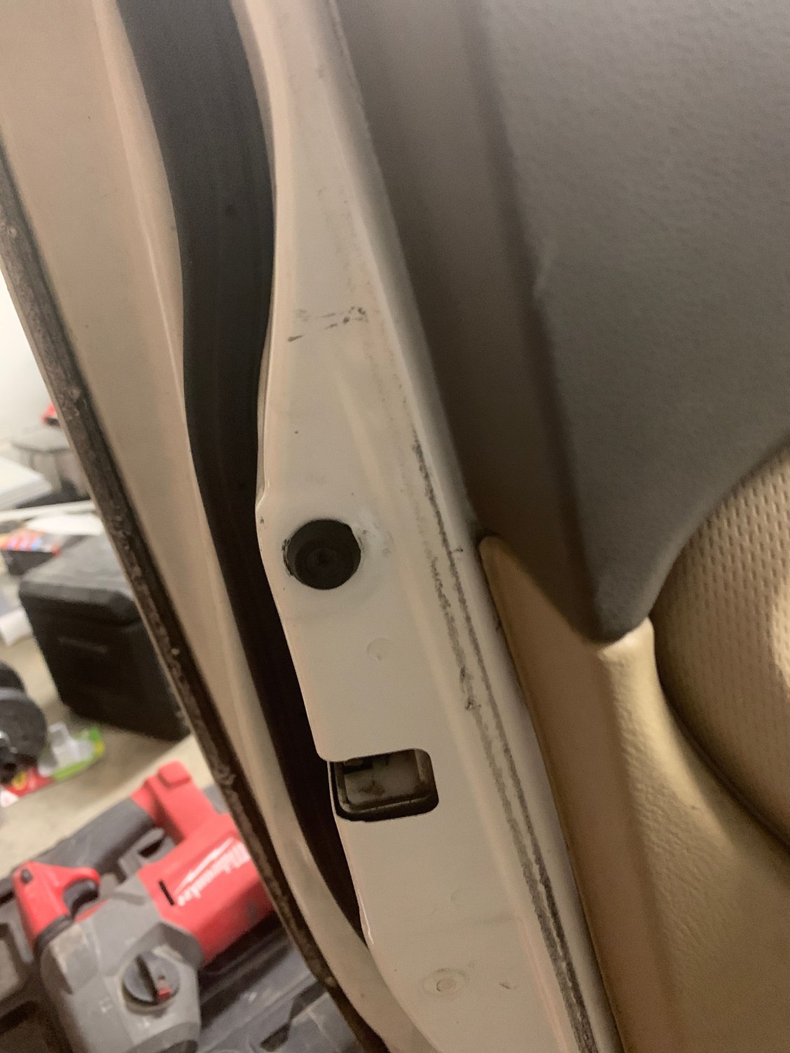

I had the same problem with the battery draining over night. I had a parasitic draw at .43 set on 10amp setting. The draw was coming for the fuse 29. So I took the dash apart unhooked everything I could. I saw when I disconnected the instrument cluster I had a drop in the drain. I replaced the cluster it was not the problem.
short answer to my problem was the plunger thing that tells your car the door is closed. I didn’t expect it being the problem because it functioned like normal. If I open the door the chime would start and lights would come on. Shut the door and it stopped.
I realized by luck when I manually hold the plunger down the drain went away. The door has a rubber bumper in it that prevented the door to push the plunger all the way in. Remove the bumper and have no more problems.
Plunger
Bumper. Just take it out

Have you still been problem free since finding this? I am having the same parasitic draw on fuse 29 on my 2012 LX. My door ajar switches also function normal. I would not have ever suspected this to be a culprit. I figured they either work or they don't. Was it just your drivers door switch that acted up? Or all the doors?
