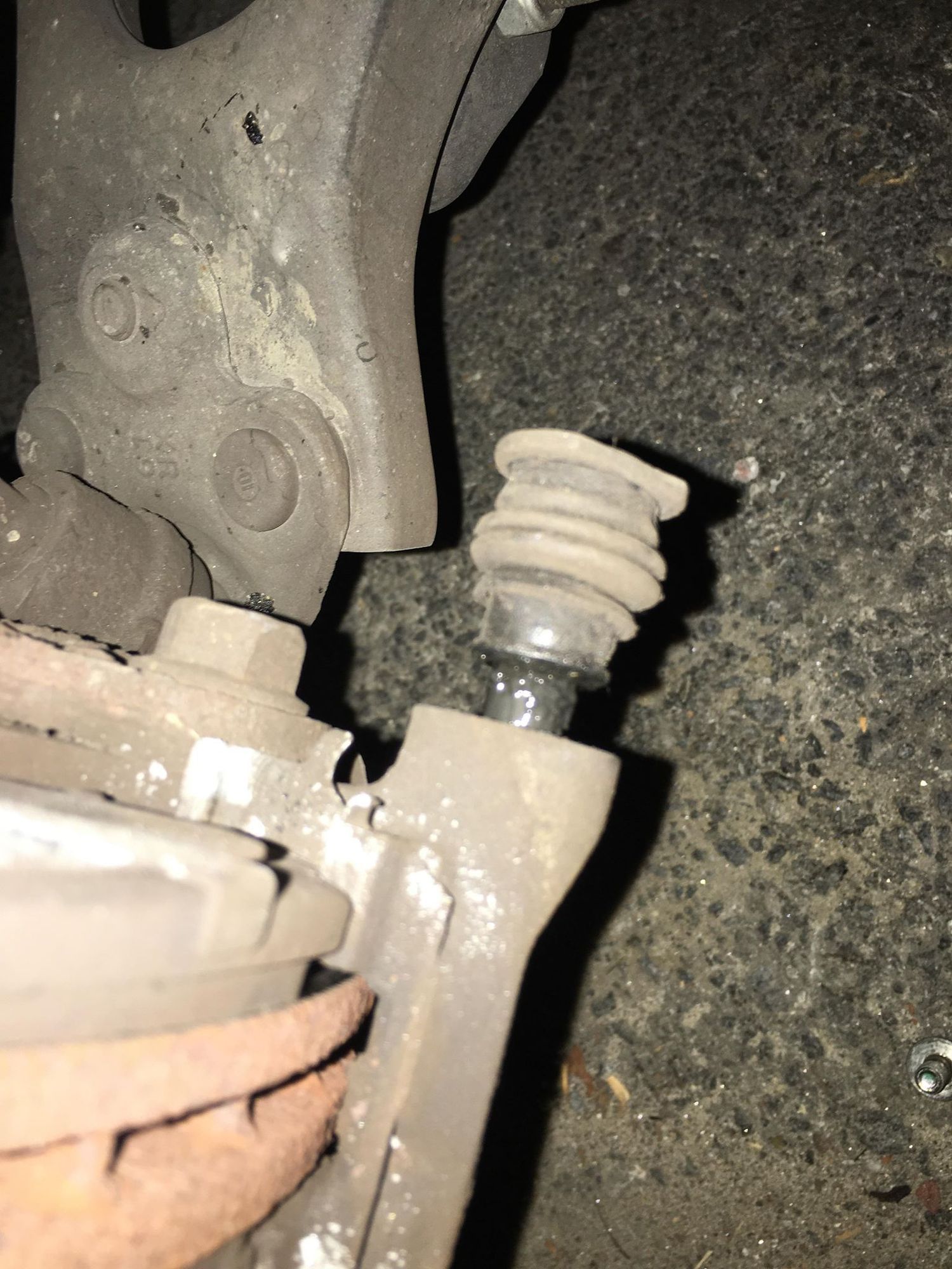

I think I might have found the culprit... both of the caliper guide pins on the passenger side are filthy. They slide, but the top one definitely has some resistance. There is a small rubber boot that connects to the head of the guide pin and also slides into the caliper. This boot was NOT fitted into the caliper. My thought: when I did the brake job in 2019, I attached the rubber boot to the pin and then pushed it in place. I had a really hard time fitting the rubber boot into the caliper. I think next time I should attach the rubber boot by itself to the caliper, then insert the guide pin and fit the boot to the pin. Right now, it looks like dirt is getting in because the boot is not seated properly into the caliper. It sticks to the pin, but the boot doesn't stay seated into the caliper.

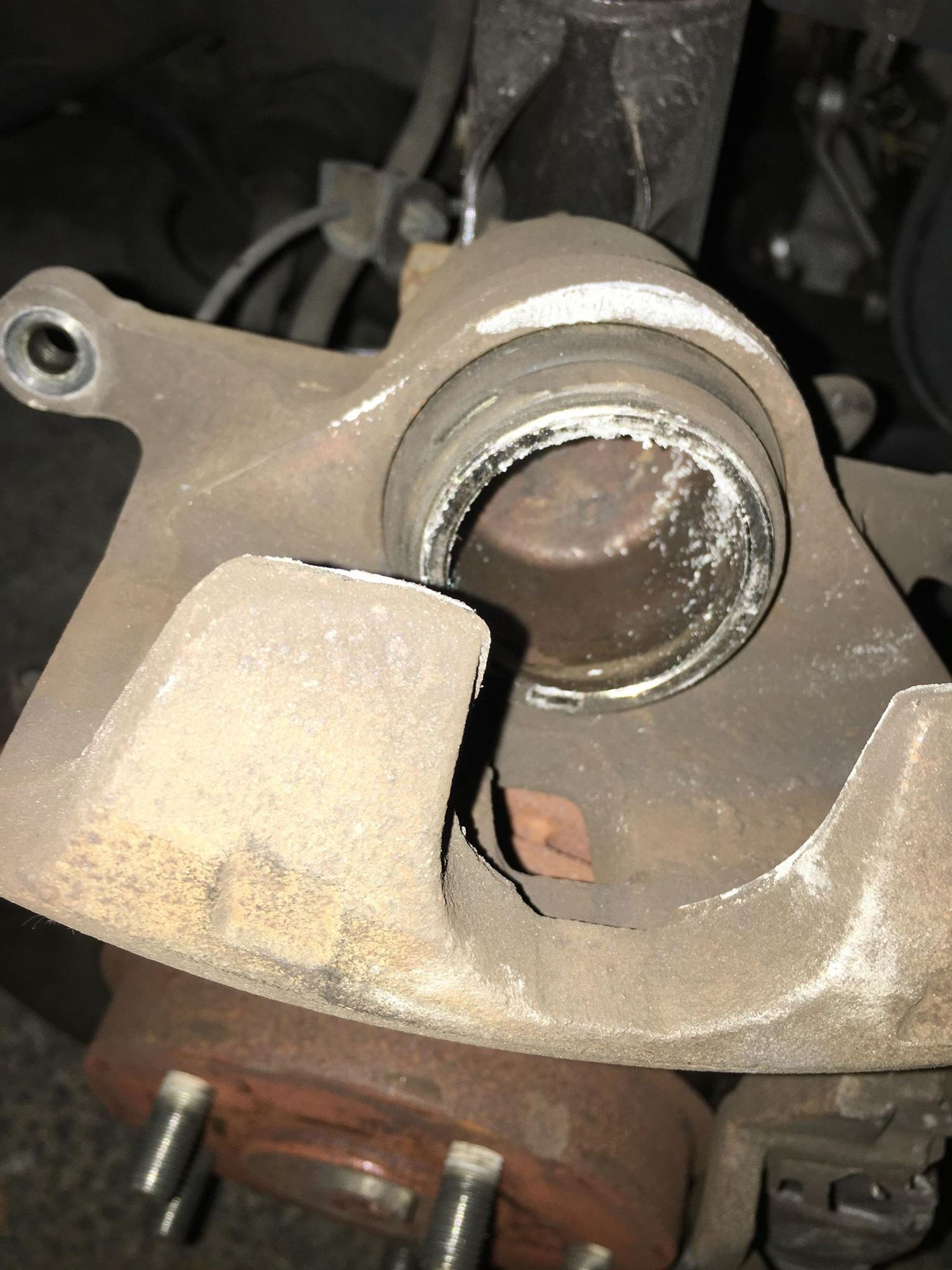

Does that make sense? I also do see a tear in the piston rubber seal. What do you guys recommend? Should I try to clean everything up? or Should I buy new caliper pins and boots? New piston seals? Should I buy brand new calipers?

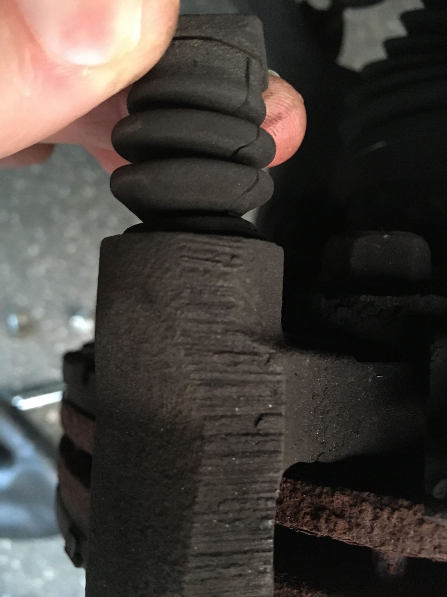

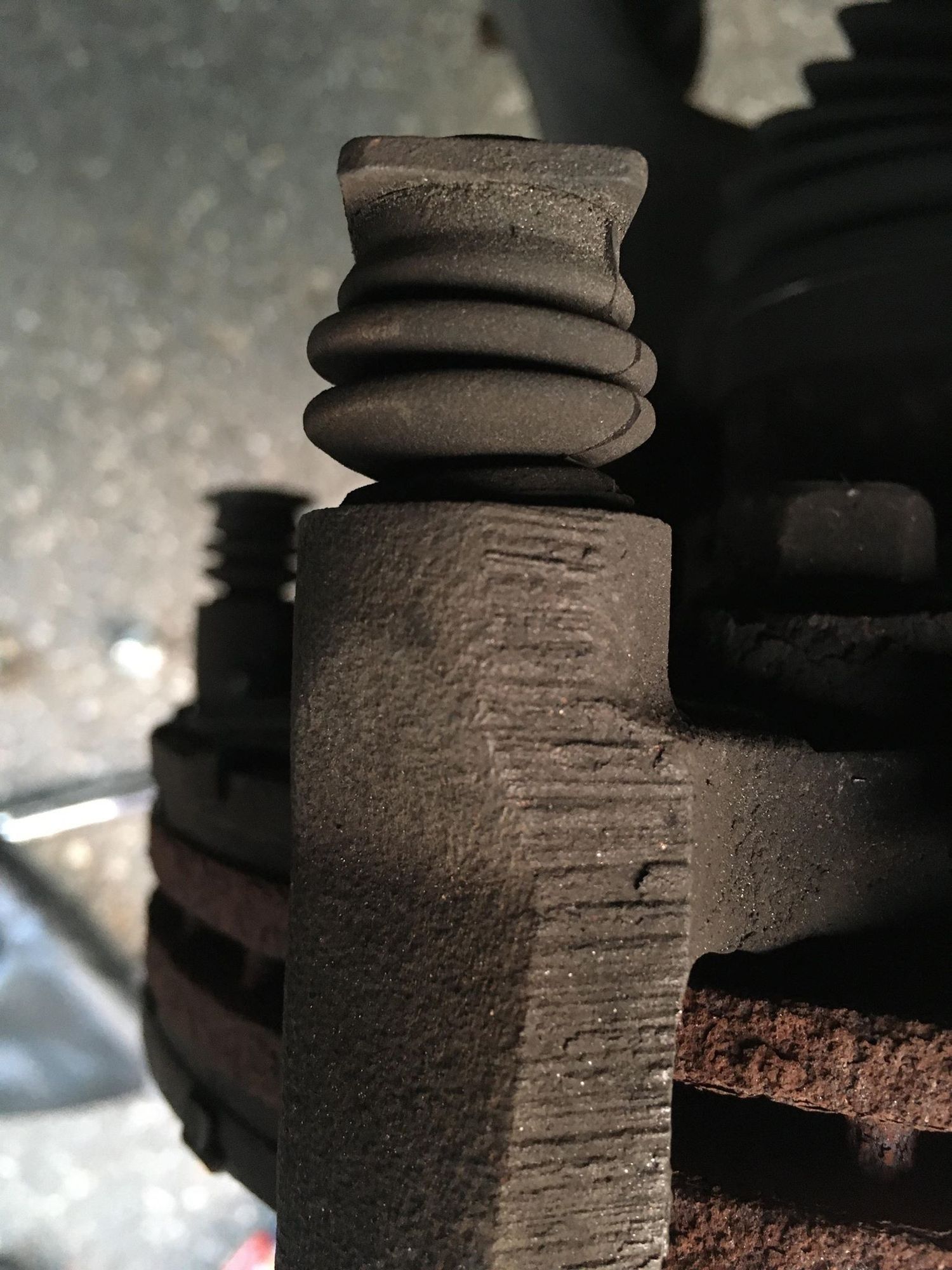

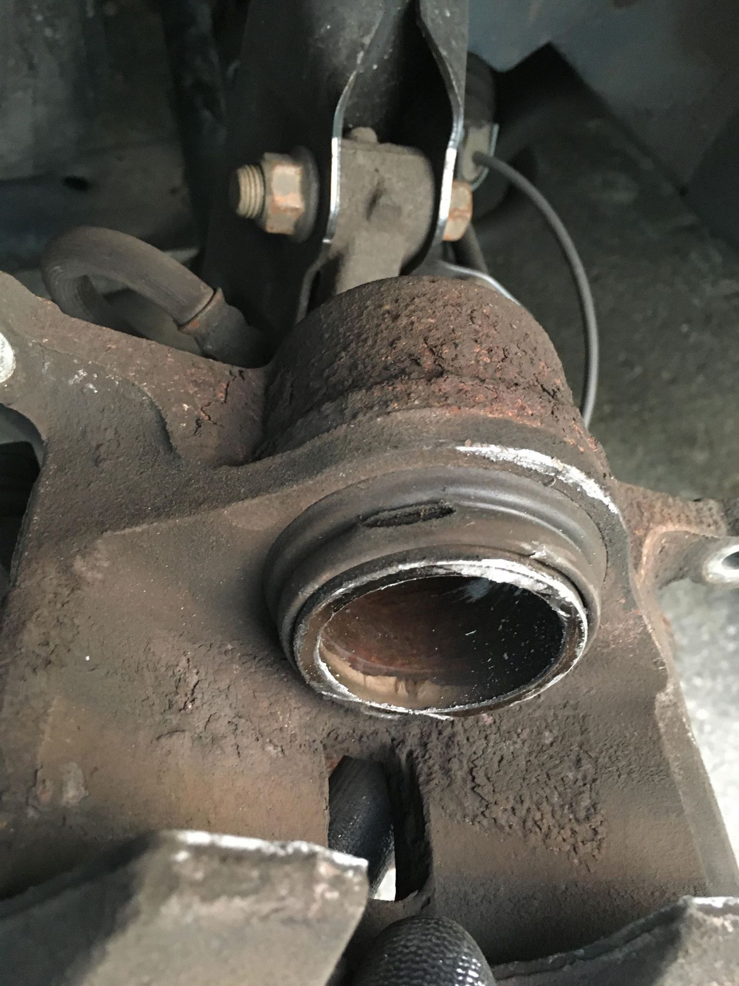

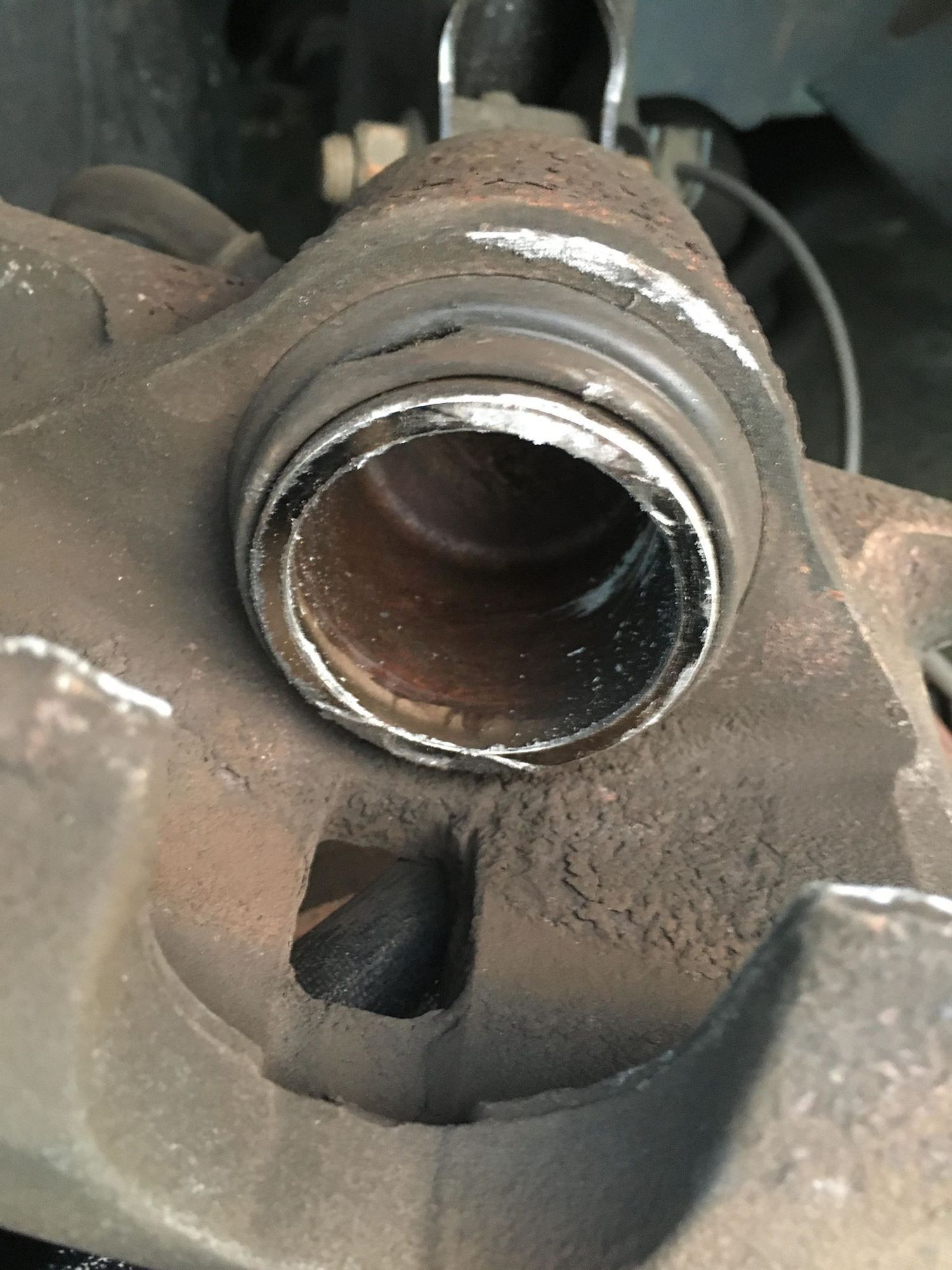

Should the pin with the rubber tip bushing/sleeve be on the top or the bottom? Could that cause such wear? Looks like the guide pins' boots on the driver's side were attached to the caliper. The boots on the passenger side were only connected to the pin. There is 1 small slit on the driver's side dust cover and 2 small slits on the passenger dust cover.
I have attached some photos.
Drivers side top

Drivers side bottom stretched

Passenger side top
Passenger side bottom
Passenger side piston 2 slits

Those calipers are likely bad. With the cuts in the boot water gets in and corrodes the piston, eventually locking it up. Those boots for the slider pins need to be seated in the bracket and on the pin. Otherwise water will get in and begin to corrode things, eventually locking it up. Both can cause excessive brake wear.
