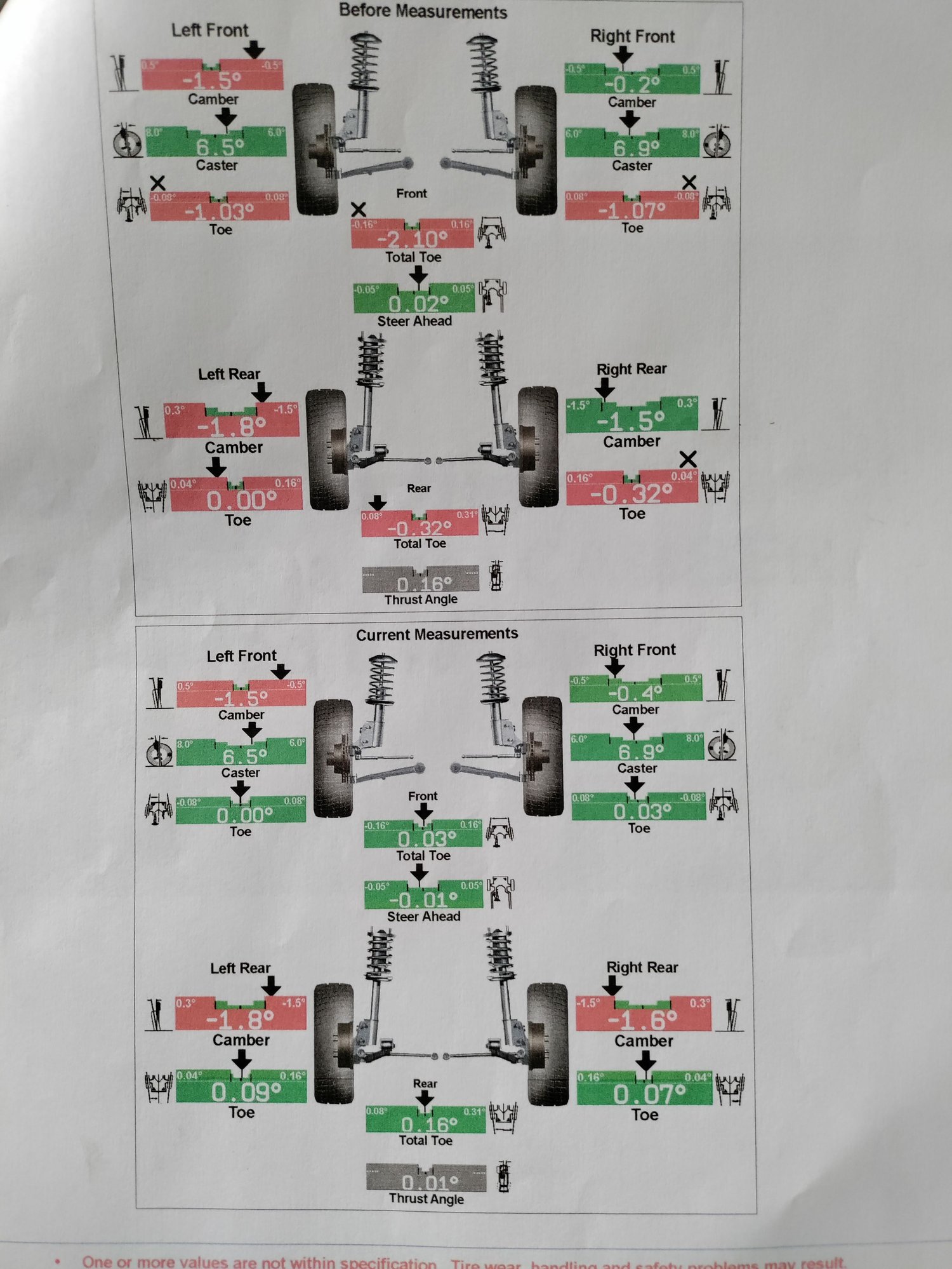

Ds front wheel is back and making contact with plastic wheelhouse. How can I tell if it's caused by damage to control arm or cradle? No visible beds or kinks. Has anyone ever purchased a new or used cradle? Are the sedan and coupe cradles the same? What about at or manual?

The alignment guy said the subframe is back on the driver side and forward on the pass side. He said that he wasn't allowed to fix it but I could try and shift it. He said I need camber bolts in front and adjustable arms in rear. This is my result sheet.
My sheet

If it's just the sub frame and control arm that's bent I would replace them. If the structure of unibody is damaged you need a new car.

I replaced the control arms and the driver side wheel moved forward a bit. The sub frame shows no sign of damage. The alignment guy said it looks shifted. I'm thinking it's in the bushing or the bolts are bent. I plan to address it when I replace the engine down the line. For now I'm getting camber bolts for the front and adjustable arms in rear. I just can't decide on skunk2 or ktune for the rear arms. Everytime I ask if anyone has used either no one responds. The skunk2 v3's have a new hiem joint with small sleeves on the side instead of a full sleeve side to side. It just looks so flimsy. Thank you for the input.
