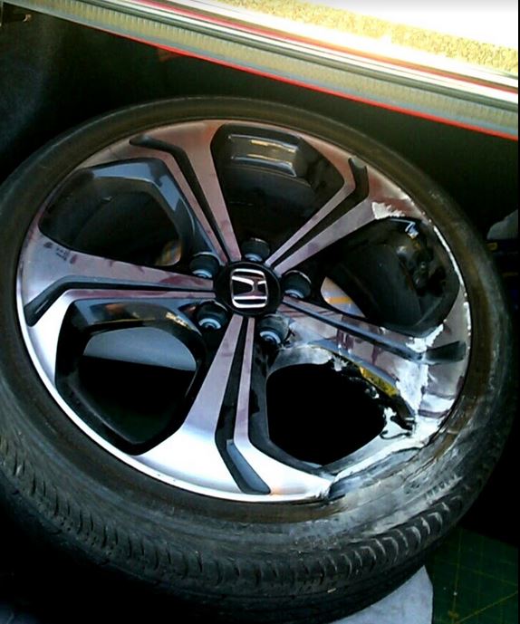

since the car was up on the rack friday and they wiggle tested the harness on the rack, not only could they not replicate the problem, but the problem has not returned. this morning we scanned the car again and no codes have come back.
my girlfriend offered up one more tidbit friday night... i love getting info crumb by crumb.. the first time she had a steering issue was when she restarted the car after trying to plow through hard plowed the snow at the end of her mothers driveway. so maybe it was moisture in the connector, or possibly she damaged/dislodged the wiring.
and yea... i mentioned accident. it was well over a year ago and has been 100% perfect since being repaired. the rack and steering motor were replaced by insurance out of caution. i was impressed with the amount of damage she did without scratching or denting the car. the rim was actually cracked on BOTH sides. one side from the curb, the other side cracked from hitting the control arm. ..see attached

Might be hard to prove it now though....wait and see how it goes I guess.
