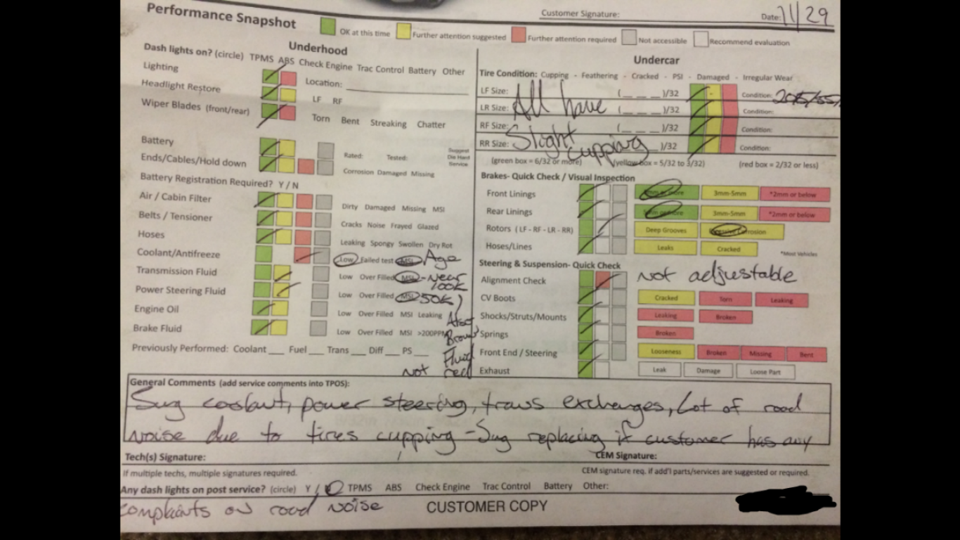

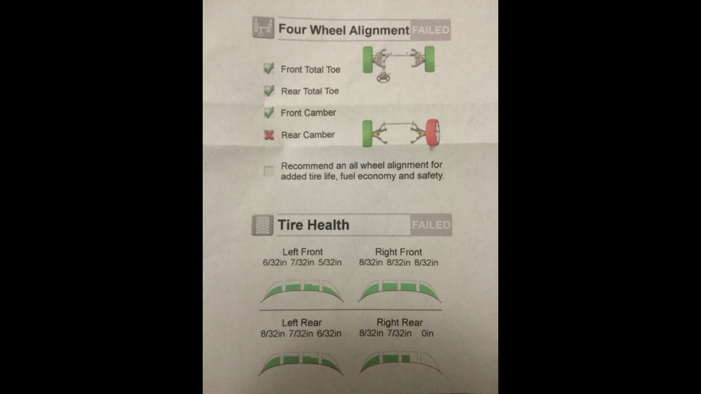

Hi, I had Vehicle inspection for my 2007 Honda Civic EX trim and the performance snapshot of the vehicle shows, "Four Wheel Alignment - Failed" and the technician gave the comment "Not Adjustable".
I am new to cars and don't know much about them. So, please can you help me in understanding this problem?
PS: As per the Technician it is Manufactured like that and cannot be corrected. Also, he told that this issue is common in Honda Cars.

A few things come to mind here:
Rear tire tread chop and noise is pretty common on that particular car.
You can search and find a lot of info on it.
Once the tires have become noisy, they may never be quiet until they are replaced.
As written, the car was not equipped with a way to adjust the suspension to correct the rear......BUT
The alignment issue can be improved, but it takes work and expense.
You don't have a true alignment printout, you have a quickie precheck that is supposed to get people to pay for a real alignment (which I kinda doubt you can get there).
Was this at a Firestone store?
The "technician" didn't bother to do any research or check service information and bulletins for this issue.
The "technician" is also recommending flushes of every kind.
That says a lot. I don't mean that in a good way.
Noted 'brown fluid not red' for power steering.....If anyone puts red fluid in there you may have some real expensive problems soon after.
Recommended a trans fluid exchange too..... that's a flush with a machine which is a huge no no.
In short, this place may not be good for your car.
You need to find a specialist that actually knows something about Hondas, cares about doing stuff the right way, and takes pride in a job well done.....
Honda has updated rear upper control arms available to improve the rear camber and reduce the tendency to chop the tread (reduce, not eliminate), and aftermarket has similar adjustable arms available but as usual they can be of questionable quality.
I've modified the original control arms to correct rear camber. I did it on my own car, in addition to several sets for customers before Honda released their updated arms for the 06-09 Civics.

My bigger issue with the upsell sheet in your pictures is the way the services would be done at that establishment. 'Fluid exchange' means a flush with a machine, and that isn't good, especially since there is very little chance anyone would bother to use the correct fluids for a Honda....... and I sure bet nobody there knows how to correctly check a Honda automatic transmission dipstick (HINT: You cannot check Honda ATF in the same manner as any other manufacturers transmission, it won't be accurate. See the owners manual for info.)
Correct way to service the transmission is simple drain and fill, using only Hondas DW-1 ATF. Never use chemicals or a machine on Hondas transmissions.
Same for coolant, drain and fill using Hondas "type-2" coolant. No machine, no chemicals.
Wrong coolant can lead to premature failures and shortened service intervals.
Power steering fluid can be done a few different ways depending on how lazy one may be, but use of the correct Honda fluid is a must.
Discount oil changes and lesser quality oil (or wrong oil altogether) can lead to premature timing chain failure, and excessive oil consumption.
Spark plugs are due at 100k too. Use the correct NGK or Denso parts.
Did anyone check the cabin filter and air filter?
You didn't say what kind of store or shop you took the car to. Chain store? Just curious.
You should contact Hondas customer service department and update your owners information, that way if there are any new recalls or warranty extensions the notifications can come to you instead of the previous owner. Have your VIN handy..
http://automobiles.honda.com/informa...relations.aspx
You should also check your VIN or ask customer service to check if all recalls and such are up to date at this time, and note which warranty extensions are still available in case you have problems down the road.
