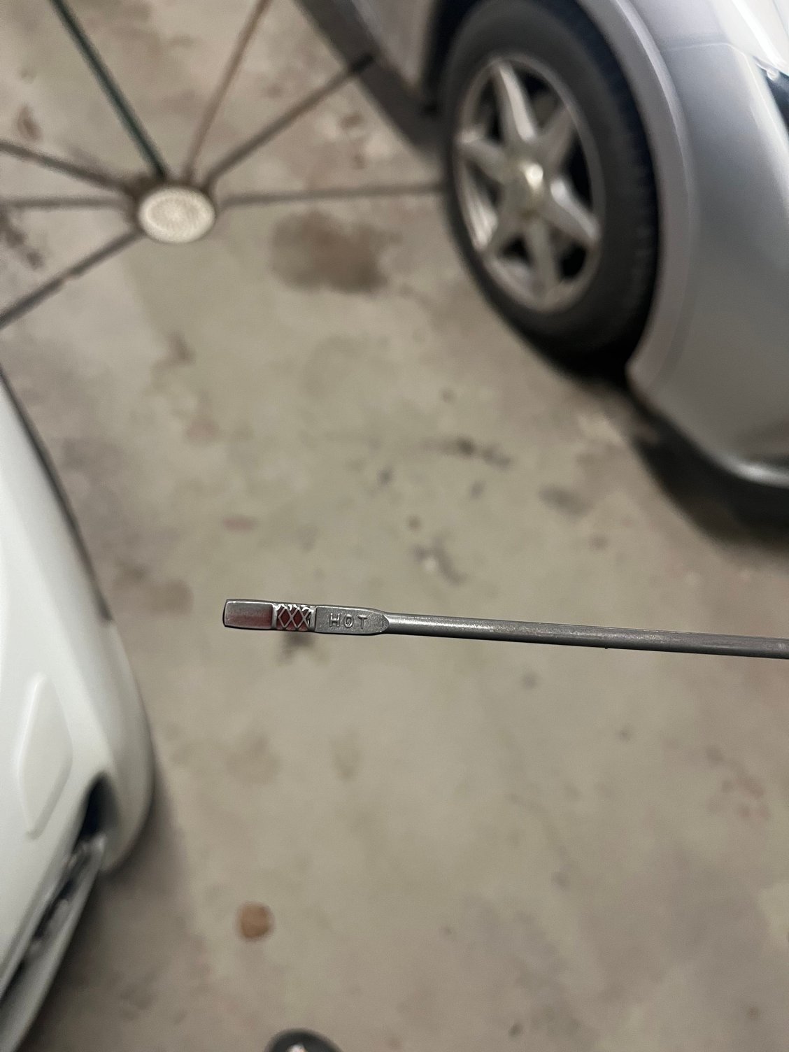

Good advice! I assembled my pvc-hose and sprayer nozzle today and sprayed exactly 200 ml out. Warmed the trans and took a reading. Se picture. Took a test drive and it does feel a little bit smoother.
you were bang on with the measurement
