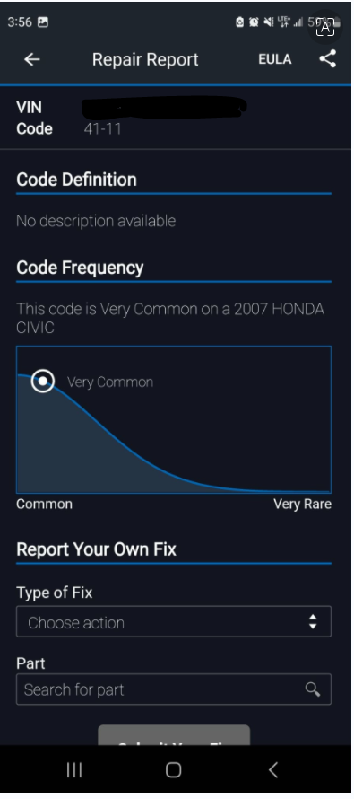

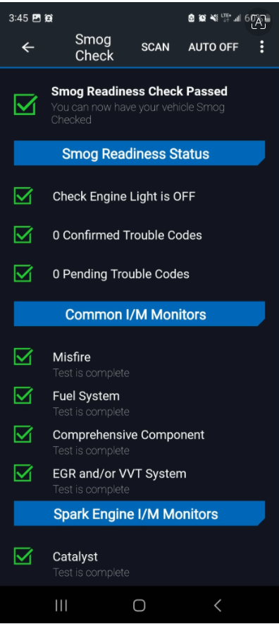

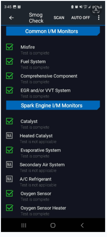

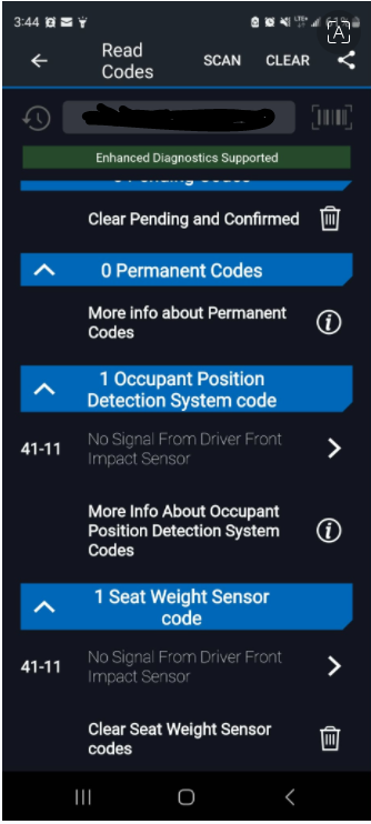

ANd I had a OBD2 tool called blue driver. I scanned and have some screenshot. if it helps. not sure if it says something like, my airbag sensor not working or something like that.
