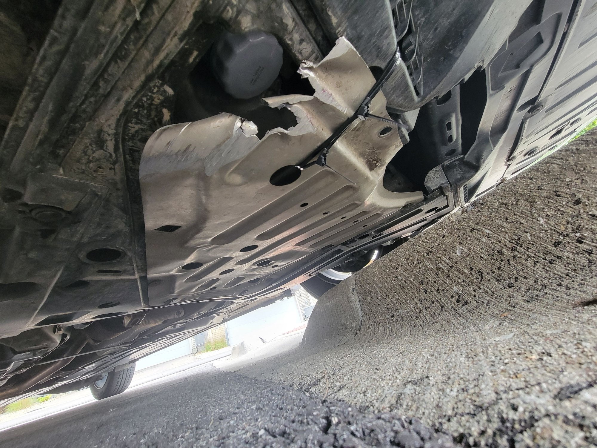

I have a 2015 Honda Civic. The place I took my car for an oil change didn't put the front engine cover back on correctly and it started scraping on the highway.
I need to replace the front engine cover plate (Part No. 74114-TR0-A00). I need the screws/clips to hold this cover plate onto (Part No. 90101-TR0-000 and 90305-TR0-000). Honda sells them for about $5/each and for 4 bolts, this is about $40. Seems kinda expensive for just some basic screws and clips. Does anyone have any recommendations for aftermarket screws and clips? I am in the US. Thanks.

I'd just go to an auto parts store and grab some random M6x15 or M6x20 bolts, some speed nuts, and call it a day. My 2018 uses those same screws to hold on the engine splash guard, and I lost them on a road trip a few years back causing my splash guard to drag a bit on the road. Pulled over and grabbed some spare regular M6 bolts I had in my car tool bag. I've been running with those ever since. Sure, the original bolt has that little shoulder, but that shoulder just helps center that hole in place. not a huge deal to not have that shoulder, at least in my experience.
