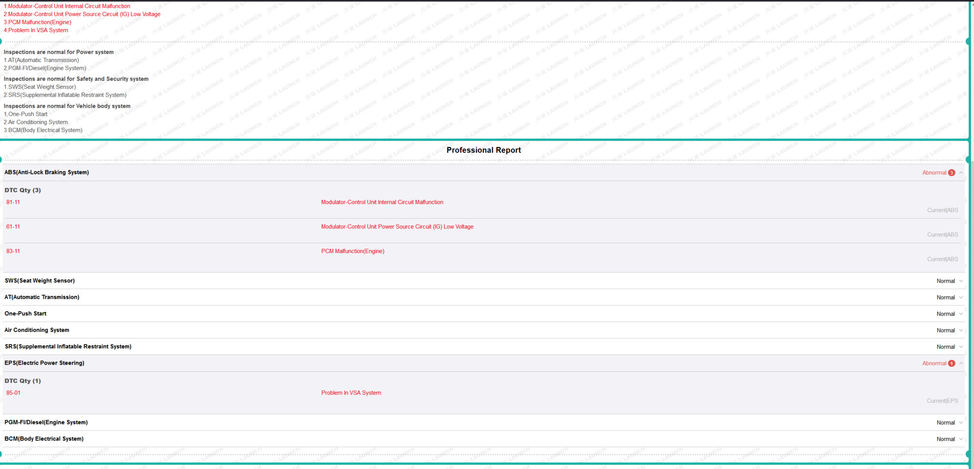

Hi, I need some help. I have a 2015 Civic Coupe EX. I bought a $120 scanner on Amazon designed for Honda, and I got these four codes. Initially, I bought the scanner because I noticed the car wasn't performing at 100%, but I have no dashboard lights on. Everything looks clear on my dash, but sometimes I feel like the car could be faster. It drives well, but it's a little annoying. This is my first Civic, so sometimes I wasn't sure if it was indeed a problem or if the four-cylinder engine was just slow. Anyway, I bought the scanner and got the codes. I did some research online and found that if I'm lucky, I might be able to replace the fuse that controls the ABS and VSA system. I already ordered a new one, and I'll try it tomorrow. I'll also try connecting and disconnecting the wire on the ABS VSA module. I'm just worried that I might have to replace the module; I looked online, and it's $1000 for a new one.
So, any advice on what I can do, or maybe I'm completely wrong, and the issue might be something else? Thanks; any help is appreciated.
Here are the codes: https://ibb.co/k2zTSDW
81-11 Modular-Control Unit Internal Circuit Malfunction
61-11 Modular-Control Unit Power Source Circuit (IG) Low Voltage
83-11 PDM Malfunction (Engine)
85-01 Problem in VSA System

First step is always clear faults and see if they come back. Some, or all, of those faults can be caused by the battery getting low.

Thank you for the help. I'm pretty sure I can read live data and check this on my scanner; I just don't know what to look for.
So far, I cleaned the codes and drove from home to work, about 40 miles, and now I only have the 61-11 code, nothing else.
I will drive a bit more to see if the other codes come up again. How long do you think I should drive until one of those codes appears, if they are going to appear?
