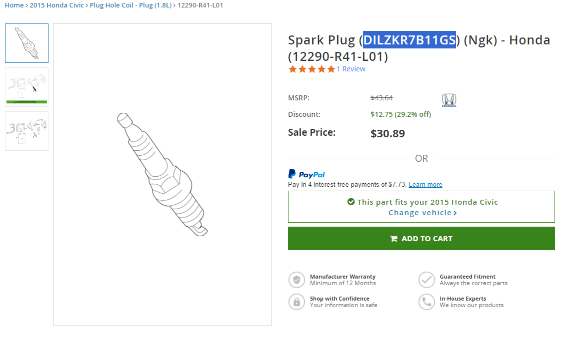

Another question I have is that Honda recommends Dilzkr7A11Gs while every other places recommend Dilzkr7B11Gs, what's the difference? I have emailed ngk and have not received any reply.

Honda OEM is DILZKR7B11GS, aka the NGK 95710.
