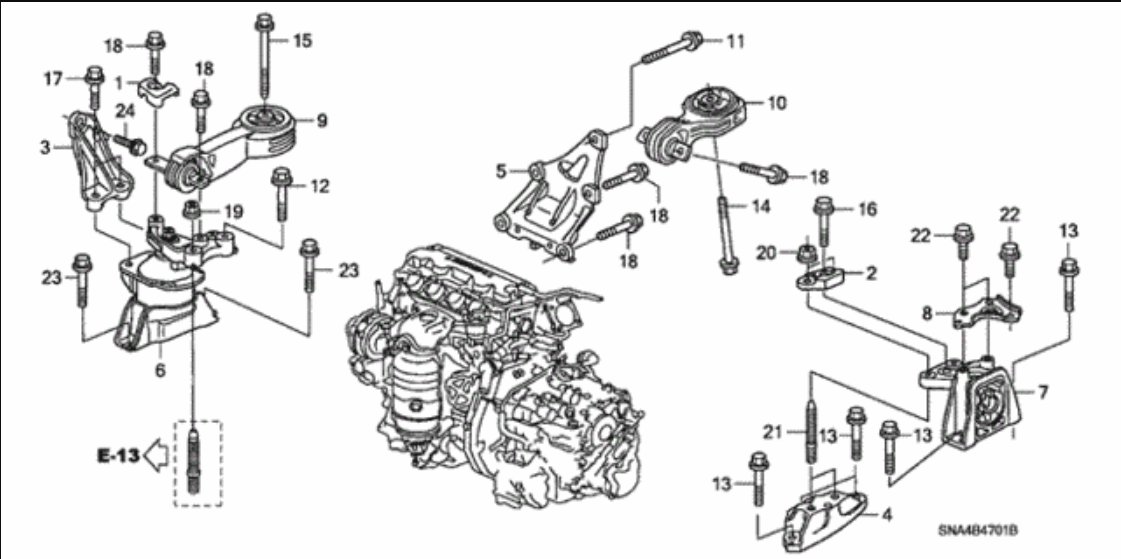

There are 2 parts of that passenger side motor mount, and that's usually the culprit. The gell/liquid filled mount (#6 on the drawing below) and the dogbone (#9 on the drawing below)
My friend had the same exact issue in her 2008 -- terrible vibration, particularly in reverse. Felt like the engine was going to vibrate itself onto the pavement. I replaced both the dogbone and the gel filled motor mount with Beck/Arnley mounts I got from Rock Auto and it's been solid ever since
