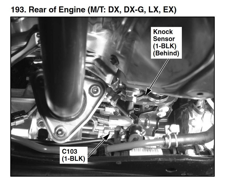

Honestly after inspecting it closely, I believe I’ll be able to get it off without removing the intake manifold.. I have the manual transmission version which is slightly different based on the pictures, however, it looks like I may be able to just remove the intake manifold mounting bracket from the back and it may allow me access to the knock sensor without having to remove the manifold. We’ll see
here is a picture I found and you can clearly see the wire between the bracket and the manifold, perhaps I’ll be able to remove it without removing the manifold.

I did get under the car and get a good look and I can see the knock sensor right above that intake manifold bracket and below the intake manifold but I’m not sure there’s enough clearance to back it out all the way.. I was hoping there would be an easier way, like possibly bypassing all the removal and just taking the manifold bolts out and lifting it just enough to get the old knock sensor out and new one in, then Just setting it back down and tightening it up..when I have more time this weekend I’ll see what I can do..
Also, in the intake manifold removal link I was provided it says to remove the throttle body, can’t that be avoided? If the manifold has to come up to access the knock sensor, why not just leave the throttle body attached to avoid having to replace another rubber gasket needlessly?

My guess would have been it restricted access to the intake manifold bolts but both on that side seem fairly accessible. You would have to try it out.
