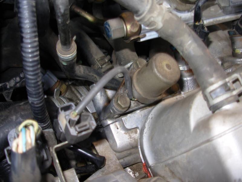

the vtec solenoid is probably what's leaking, it should be on the back of the head, near the trans side of the engine
random google pic of a vtec solenoid:

Sweet, imma checl it out. Thanks. That is just RTV sealent? No gasket?

no it has gaskets

One of the gaskets isn't really found in the Honda parts catalog.
Search forum for posts with TWO part numbers for the VTEC gaskets from Honda.
