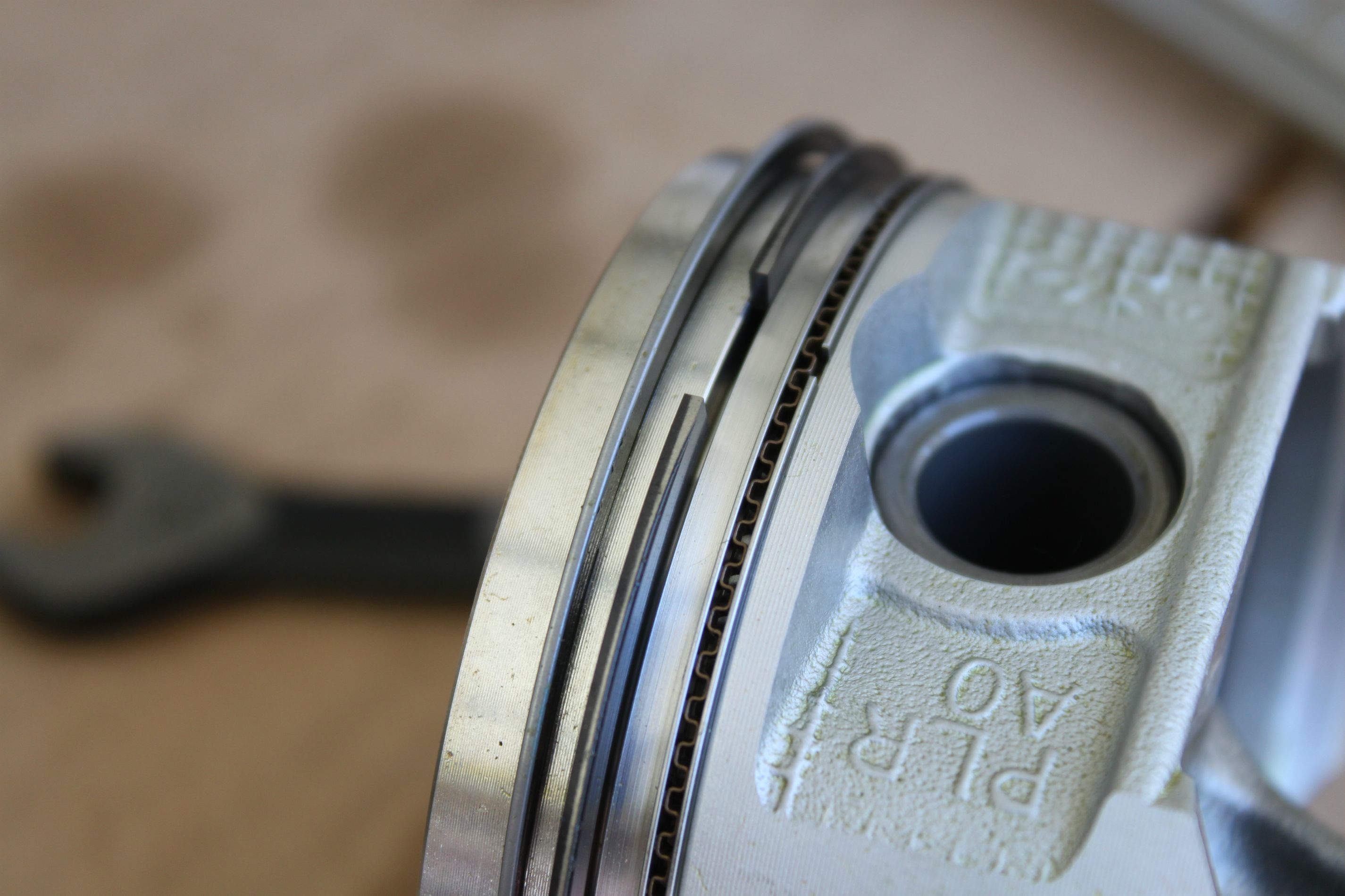

Edit: to give OP a frame of reference, here's a pic I have of a d17a2 piston I just so happened to have on my imgur.
Engine it came from had less than 1000 miles on the clock, but has been sitting for some time, hence the disassembly
