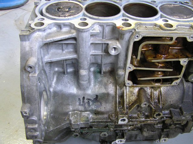

The red squiggly lines are where the cracks will be up behind the starter.
There can also be cracks behind the black cover, but the coolant will go into the engine oil if that happens.
Hope your VIN report is clear and valid for this repair!
EDIT: Here's a pic of the real thing that was leaking coolant from cracks behind the starter

Thanks Ezone, It took me a day, but I did figure out it was a 1.8. Thanks for the help on that. And also since I could not see any reason coolant would be coming from the attachments, I figured most likely source was the cracked block. Went in and talked to the dealer, looks like the block has been reported cracking just above the starter, which could easily run down and show up where I saw it. Car is scheduled to go in to the dealer on friday morning.

Ok guys, thanks for all the help. Honda confirmed this morning it was indeed the cracked block. so an 8 year old car with 206,000 miles is being covered under warantee, pretty remarkable, and this 6 months after they repainted the car.
