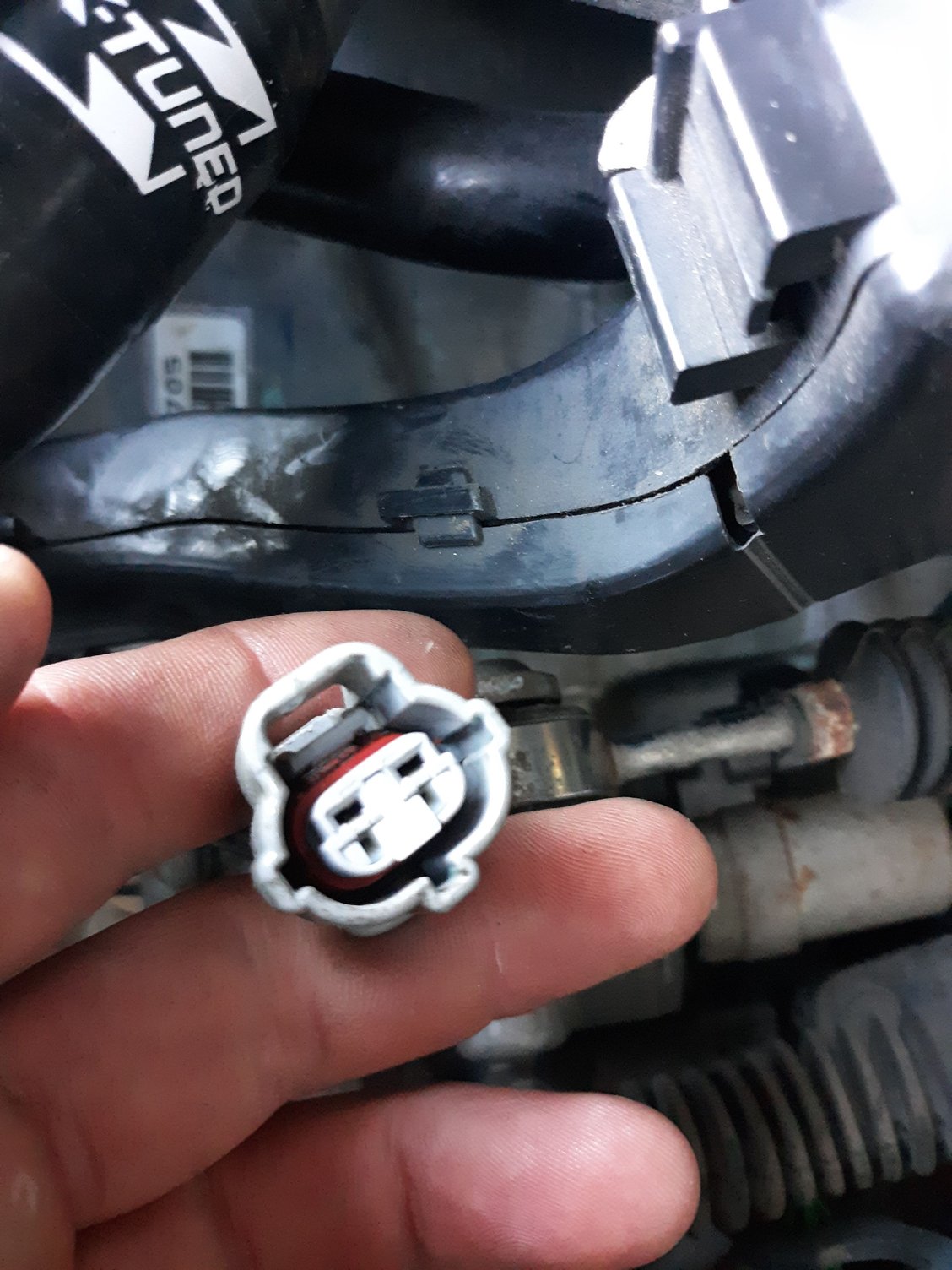

Lil off topic, but do u know what this is, its leaking coolant, and what part number would it be?
Old Nov 24, 2019
Colin42's Avatar
Posts: 9,638
Likes: 1,283
From: Barrie, ON Canada
Rep Power: 222
Re: 08 si running lean, please help!
Probably a temp sensor
Old Nov 24, 2019
05es1guy's Avatar
Joined: Jun 2019
Posts: 83
Likes: 7
Rep Power: 84
05es1guy is just really nice05es1guy is just really nice05es1guy is just really nice05es1guy is just really nice05es1guy is just really nice

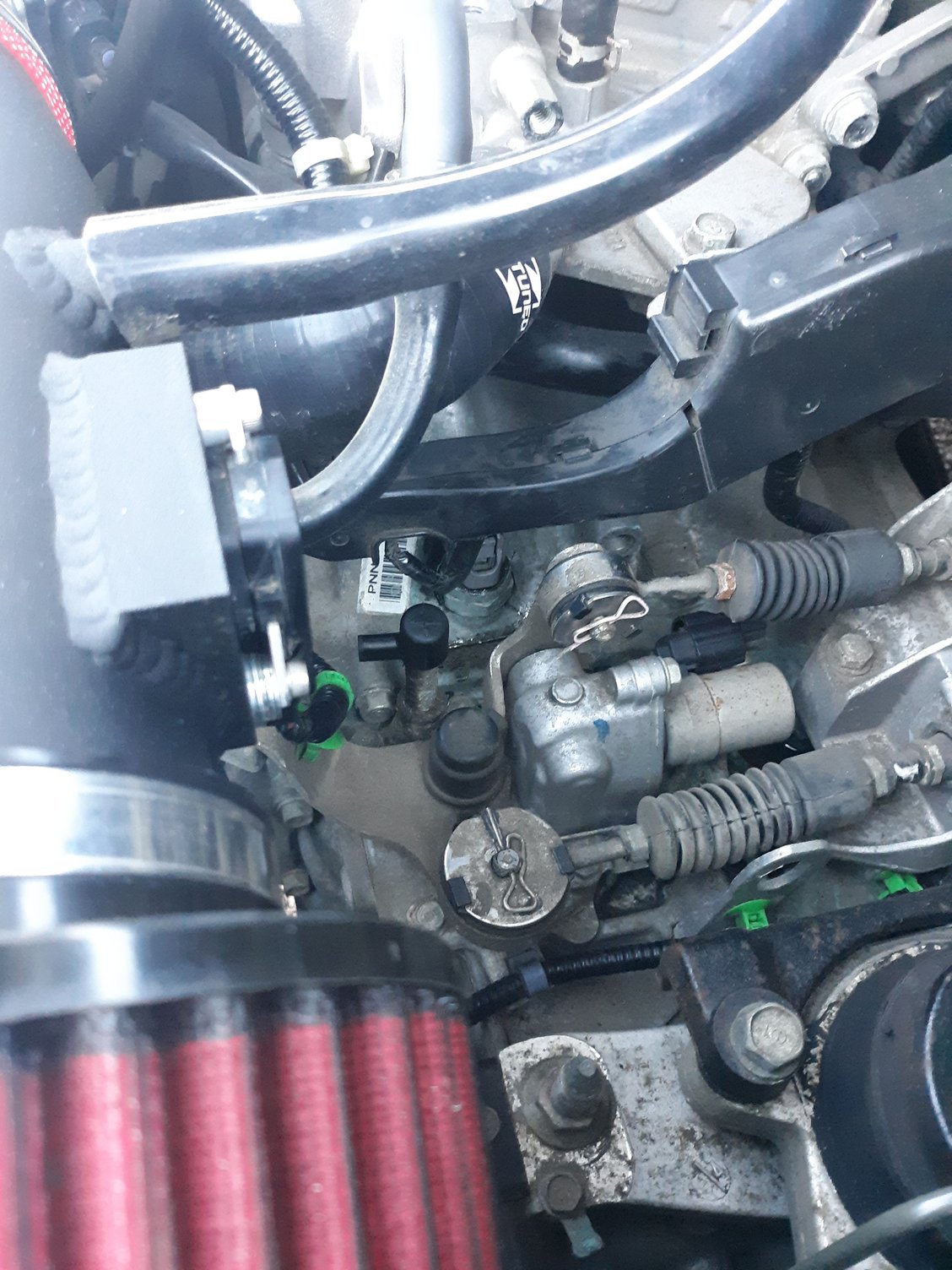

You would thing, but I went to three autopart stores and the coolant temp sensor they give me looks nothing like what I need, this sensor is underneath the radiator hose, next to the shifter bushings
Old Nov 24, 2019
Rep Power: 512
can you take a picture a bit further out? trying to see the position of it on the engine so I can compare part numbers and pics

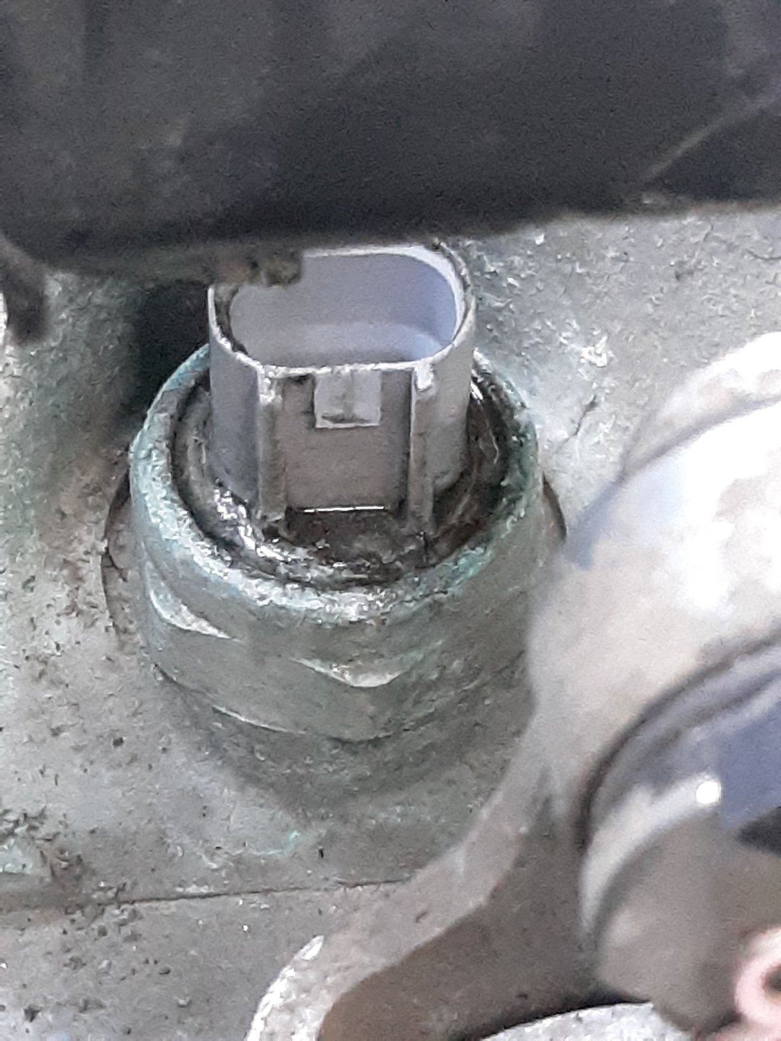

That is the back-up light switch, it has nothing to do with coolant. It has to be leaking from somewhere else and ending up on that sensor.
Old Nov 25, 2019
05es1guy's Avatar
Joined: Jun 2019
Posts: 83
Likes: 7
Rep Power: 84
Weird, haha but ok, thanks, I'll try to figure it out
"edit"
just checked with car running, it most definitely is leaking coolant out of whatever sensor that is, for sure. Saw it myself leak out, everywhere else is dry
Old Nov 25, 2019
Rep Power: 512
Oh ****, that's on the tranny itself. Initial pics, I thought the sensor was sitting horizontally.
"edit"
There is no coolant in the transmission. I understand it looks like it is coming from that sensor but it has to be coming from somewhere else. The main water passage is directly above that, possibly coolant is leaking into/onto the harness and running down into/onto the sensor? That sensor could cause a transmission fluid leak but it wouldn't look anything like coolant.
Yea, that's whats confusing literally everything else is dry
and I'd have to look again, but I dont actually think it's in the trans, it's part of the block just after the trans case

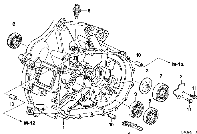

Technically it's in the clutch case, still part of the transmission. Number 5 in the below pic.
Old Nov 25, 2019
05es1guy's Avatar
Joined: Jun 2019
Posts: 83
Likes: 7
Rep Power: 84
What is that part?
Old Nov 25, 2019
BrotatoChip's Avatar
Super Moderator
Joined: Jun 2012
Posts: 5,073
Likes: 2,096
From: Ohio
Rep Power: 224
Switch Assy., Back Light
Part Number: 28700-PHR-003
It is a switch that turns on the reverse lights when the transmission is shifted into reverse.
