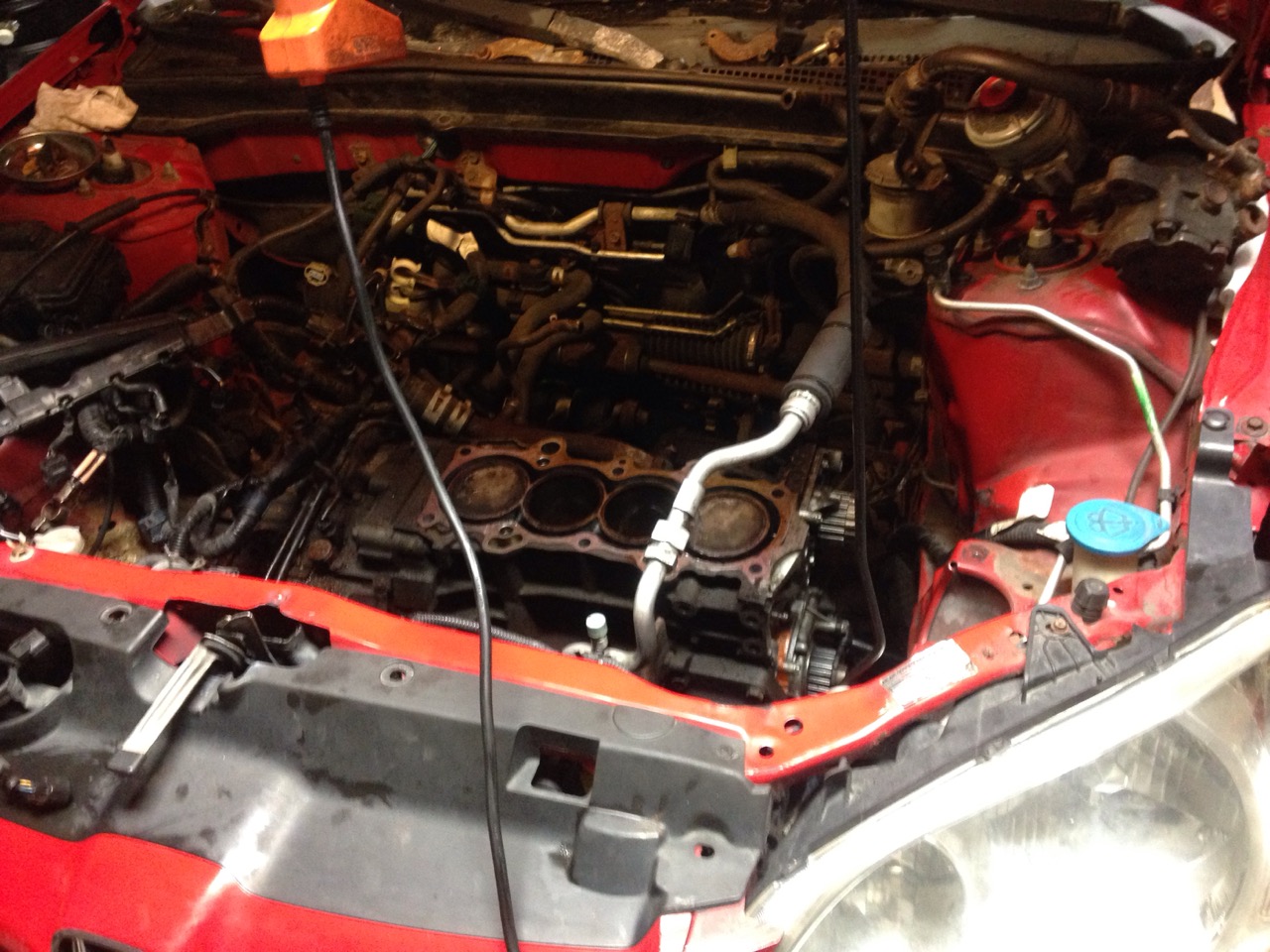

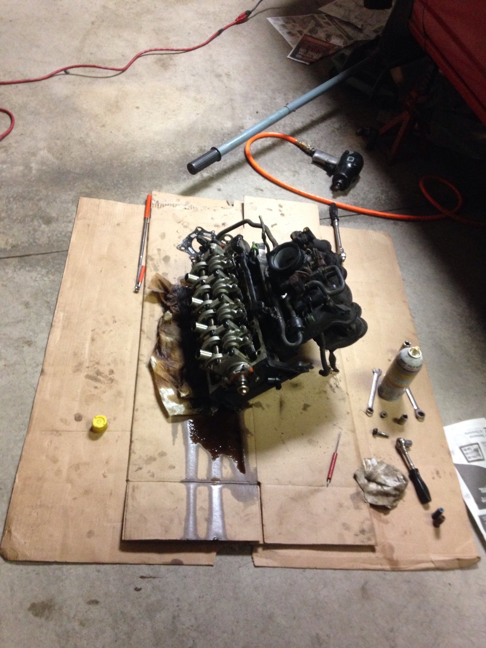

the head I found is d17a2.. forgot to elaborate.. here are some pics..
car is old, i know how to build cars... but hell who doesnt like some bang for buck....
here is some pics of teardown..

no , i just took the head apart, i got bent 12 valves leaking , only 4 good. ouch thats going at 20 mph.. no damage to cylinder. so am either putting new one i found a complete set for 65 dollars.. or do the swap... i need the car.. the wiring bothers me an vafc2 .. if i had the time no problem to play around, but now am looking at time down.
