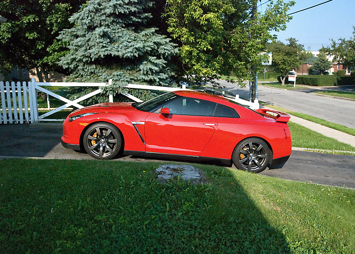

Moving on to the write up here is the first walk around the car.

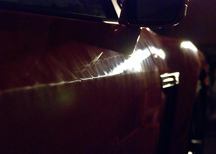

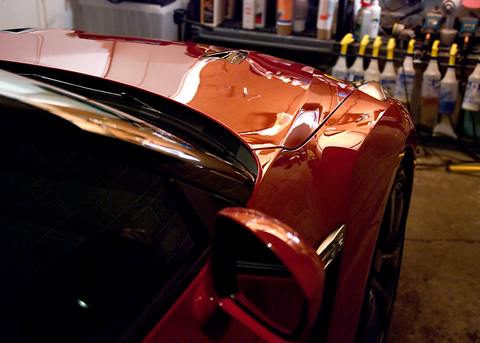

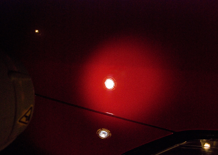

Already noticed a buffer trail that needed to be corrected

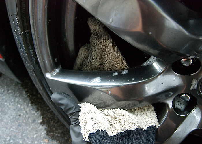

As usual starting with the rims, I cleaned the face and behind with a microfiber wash mitt

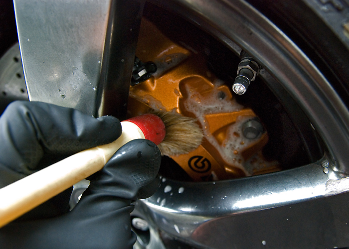

Used my brush to clean the calipers

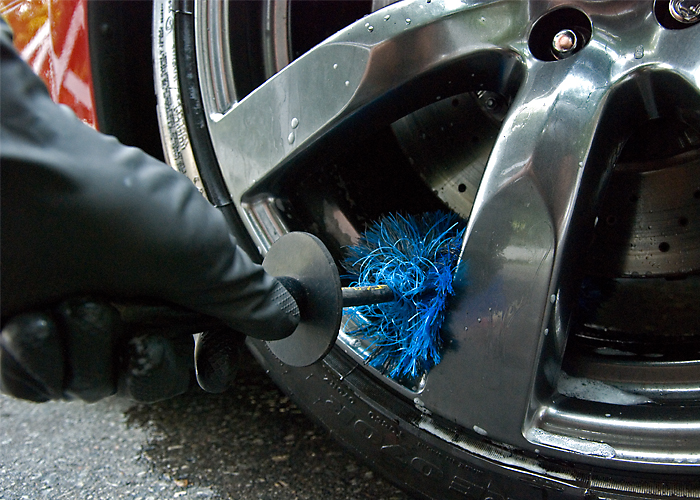

And my EZ Brush to clean the inner barrel

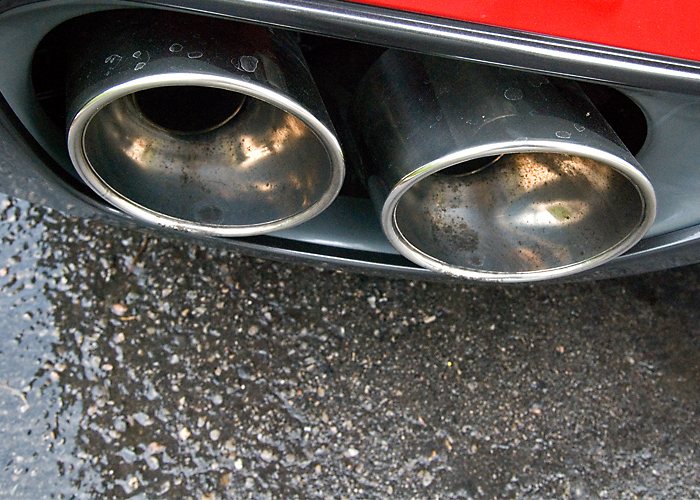

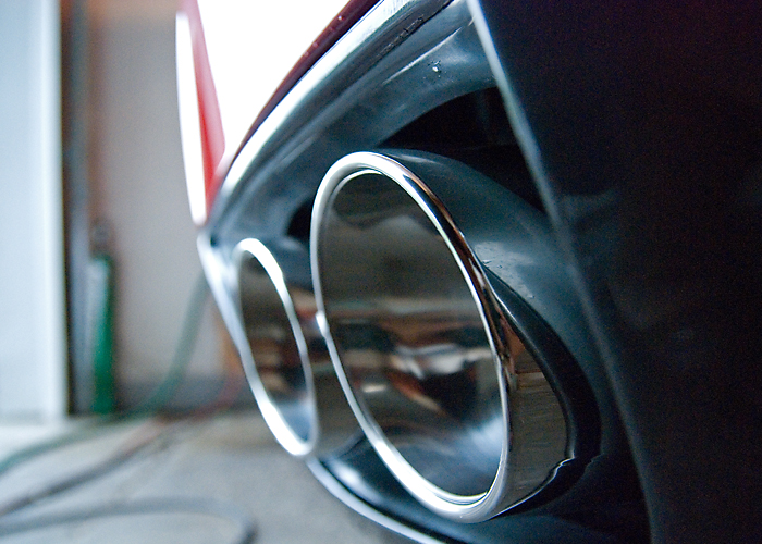

The exhaust was not to bad and was sort of an easy clean up

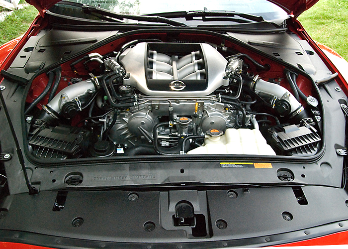

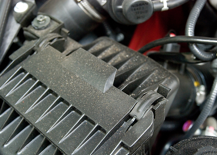

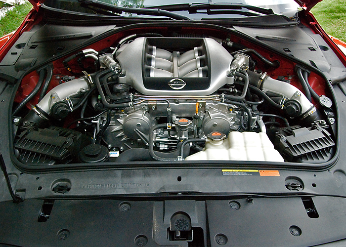

Moving on to the engine, it was not at all in bad shape but just a little dusty and could use a quick clean up and dressing to make it look new again
Dusty
All clean and dressed up

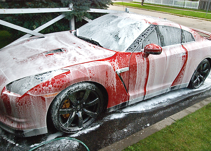

Finally getting onto the wash stage the car was foamed down

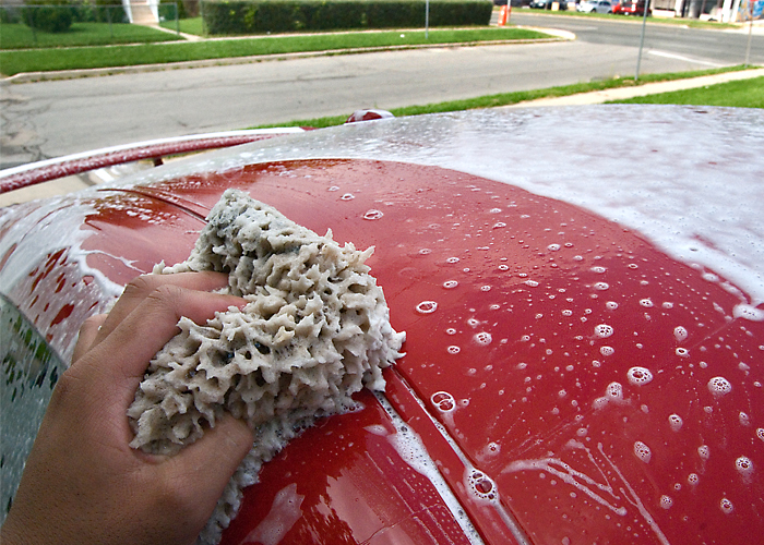

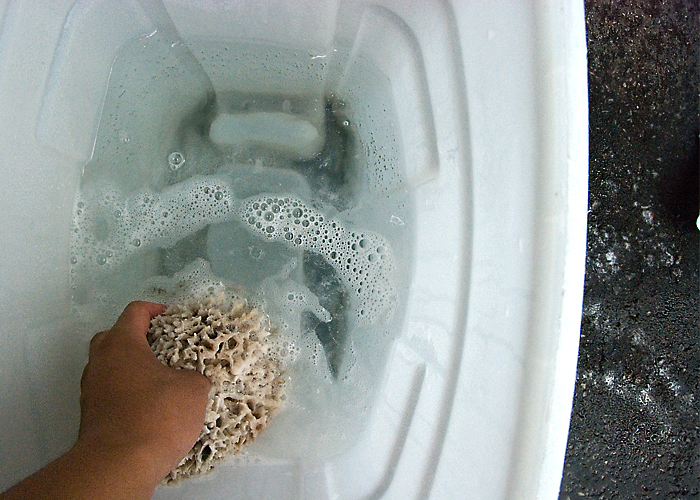

I 2 Bucket Method washed the car with my natural sea sponge
And rinsed off my sponge in the water only bucket after every panel or half a panel

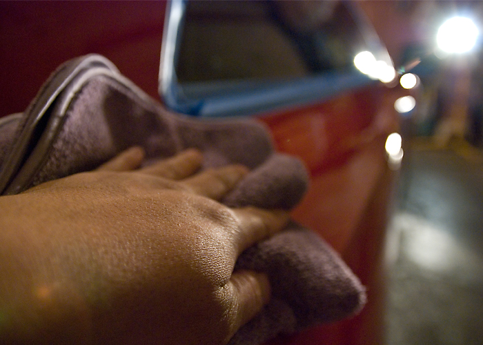

Then dried the car with a plush microfiber towel

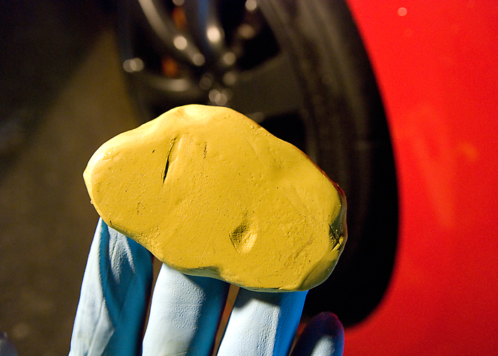

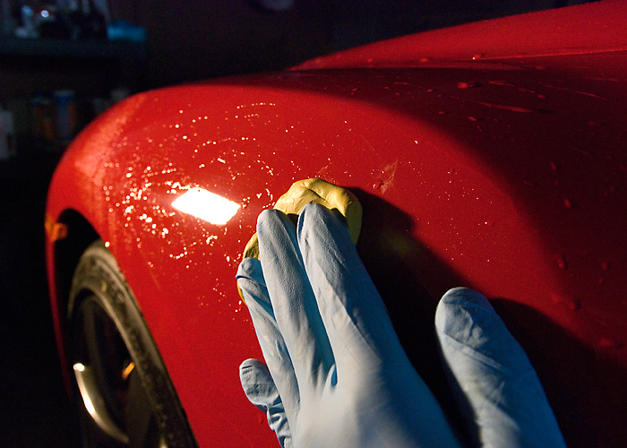

Brought the car in to clay
And it was not in bad shape at all

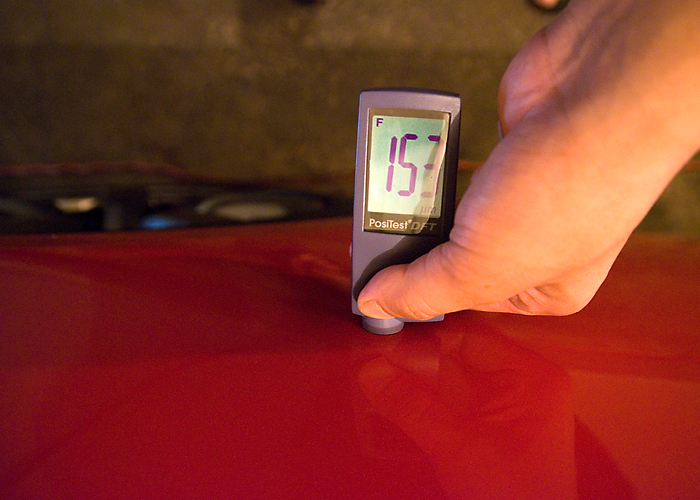

After the claying I measured the paint to see what levels I was working with

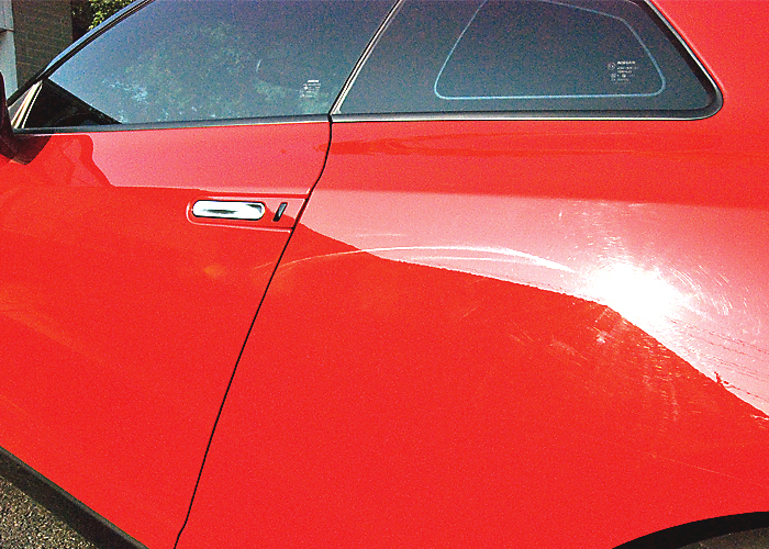

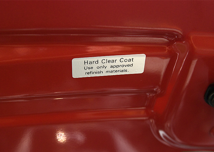

I found a section that was repainted and learned that the car had come with a huge scratch from the factory and this section was repainted under warranty which I guess also explains the buffer trail I first noticed
repaint

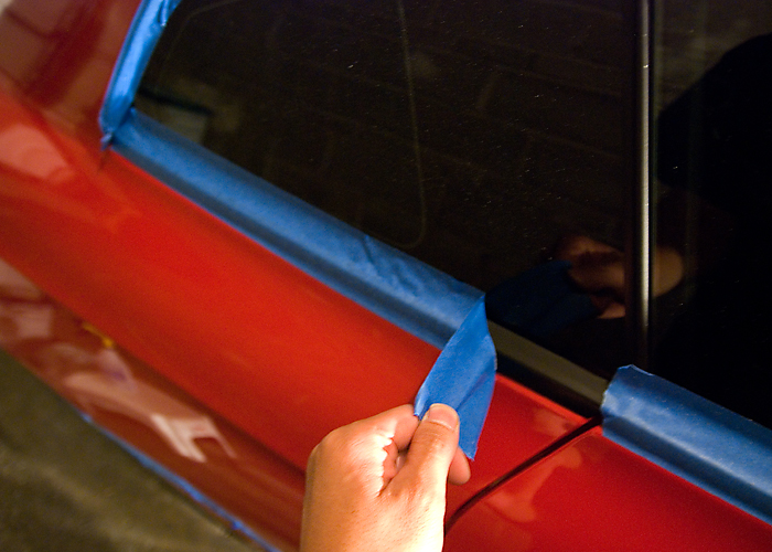

I masked all the rubber trim

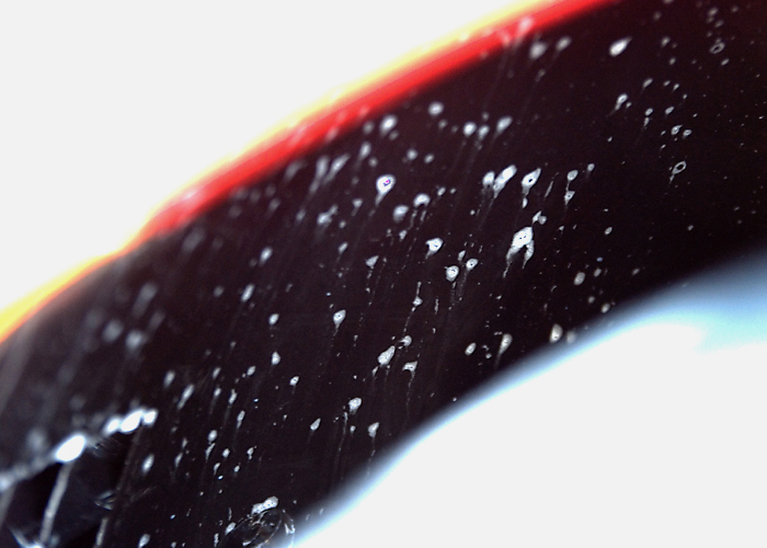

And now could begin polishing. The combo I opted for was Menzerna SIP with a Orange Lake Country Pad on a Makita rotary. Here are the befores and afters of a few panels
Before
After
Before
After
A quick shot of yours truly polishing
Before
After
Before
After

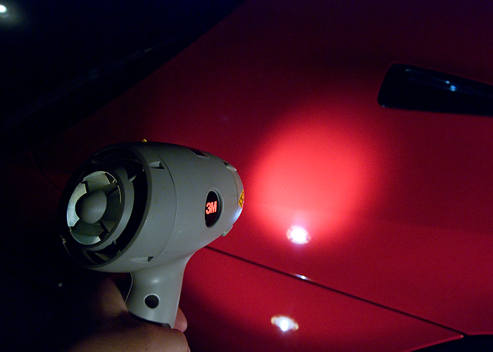

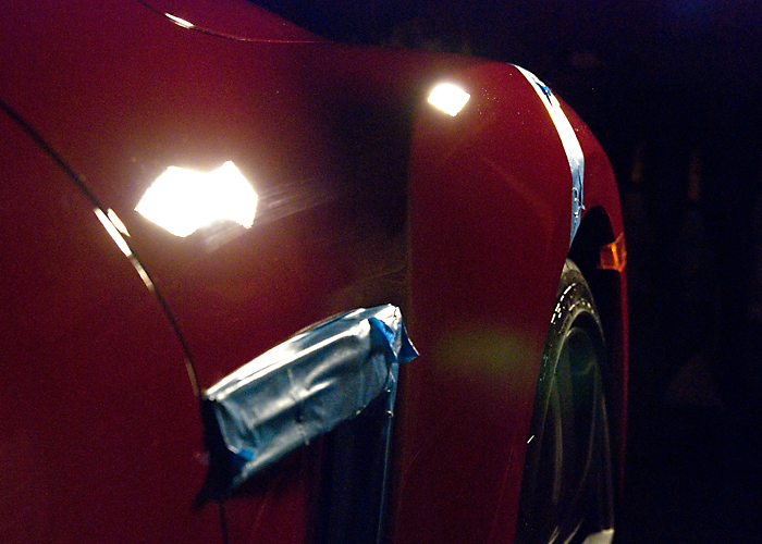

After unmasking and cleaning off the polishing oils I inspected the paint with my 3M Sun Gun which omits the same spectrum light as the sun.
Perfect

While the wax was curing I attended to other areas like putting Poor Boys Wheel Sealant on the rims and exhaust
Here are a couple after pics of the exhaust

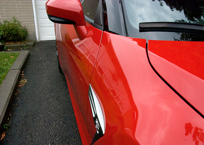

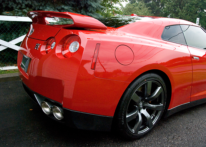

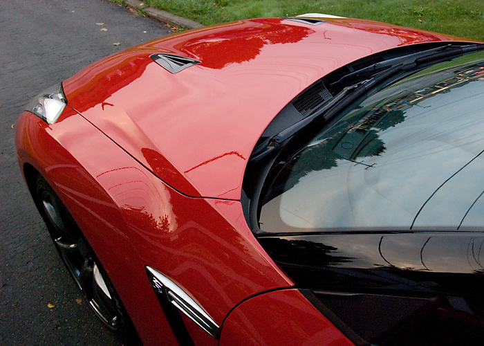

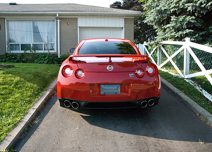

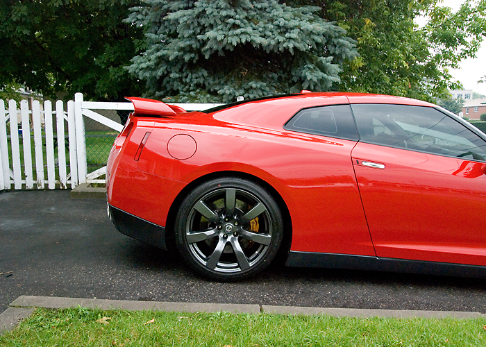

Unfortunately it had rained but I got a small window to quickly take a few after shots which I don't think turned out that bad and actually it was kind of cool to still see the paint looking very glossy on a cloudy day

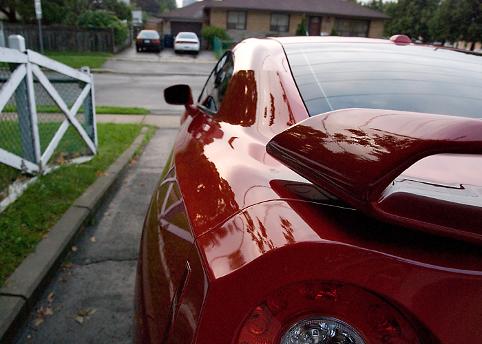

The gloss was looking very nice in this pic

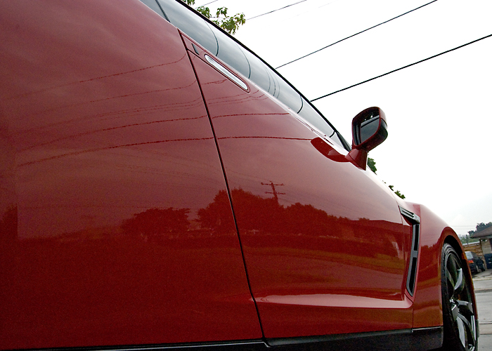

Some nice reflections
I liked the reflection in this shot

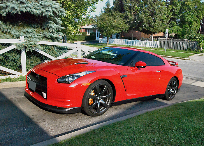

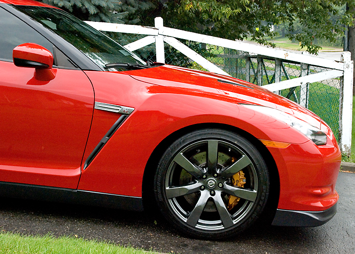

And to complete the walk around
Finally my last 2 favorite pics
Dusty
repaint
Before
After
Before
After
Before
After
Before
After
Perfect
