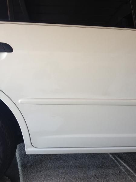

Not too sure if the pics can do it justice...The paint is still glossy and white, but it's just...dirty! The only way I can get these off is with rubbing compound and elbow grease. What is it? Should I just buff it out with rubbing compound and my orbital? After it's off, is there anything more I should do?

Looks like the Meguiar's wax I stopped using, after a few weeks it would turn dirty like that.
Use a good Mothers Carnauba Cleaner wax instead.

Claybar. Then a good carnuba wax.

Clay bar or some lacquer thinner on a rag. As long as you have good clear coat, the thinner wont hurt it at all...I mean...obviously you can't just let it sit on there. But dampen a rag with some, wipe it over then rinse with a little water. If that doesn't easily remove it then you'll have to do what the mod said gl
