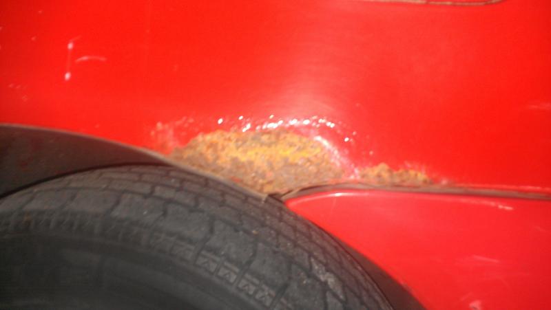

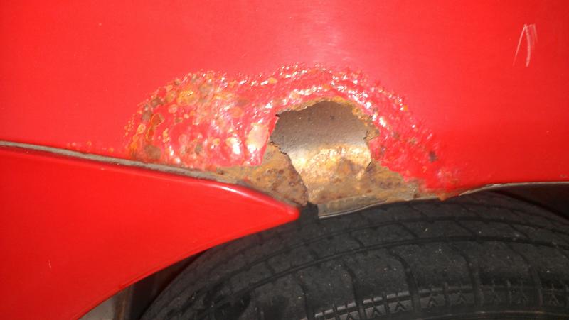

Im not too sure if this is in the right topic but, i have a 1995 Civic EX and there is almost nothing wrong with it. When i took an auto mechanic class it wasnt like cosmetics or anything (obviously). It was all in the engine. So i know almost nothing about fixing the exterior of my car. I just need to know if there is any way of fixing these few problems myself or if i should just take it to a body shop.
this is on the side above the passenger side rear wheel:

This is on the side above the driver side rear wheel:

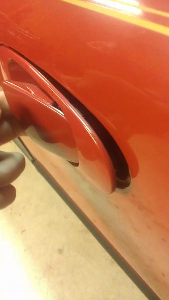

This is the passenger door handle:

for some reason the pics didnt show up, the first one is on the left, second in the middle, and 3 on the right.

Rust above the wheel wells is a cancer for hondas...The best way to deal with it, unfortunately is to cut away all of it, replace with some sheet metal and bondo that in and repaint. Job for a body shop definitely. For the door handle, you could try some 3m glue. Just make sure you use it somewhat sparingly and apply some pressure to it for 5-10 minutes after you stick it in there. If some excess drips out, you can use lacquer thinner to wipe off that stuff. Dunno about the hood. GL
