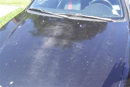

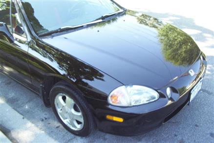

Hopefully this works
Name:	Del Sol hood b4 resized.jpg
ID:	58199   Click image for larger version
Name:	Del Sol Front After resized.jpg

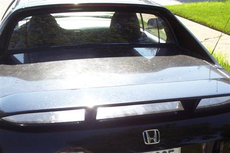

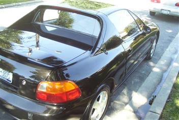

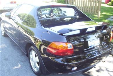

more pics
Rear of car before
Rear of car after detail
This car had 140k miles on it...and it took me 5 hours....4 hours on the exterior. It was a mess

Washed the car with Malcos very berry car wash
Clayed the car with 3M clay
Washed the car again to remove clay residue
Dried car
Compounded car with wool pad and Malcos Tru Grit
Glazed car by machine using Malcos Restore it (Cleaner and Glaze)
Glazed Car by Hand using #7 Meguires
Waxed car with carnuba wax
Washed car to remove all the polish dust
Waxed car Using NXT
Wiped down whole car with Micro fiber towel
Passed out lol....It was hot and humid that day
