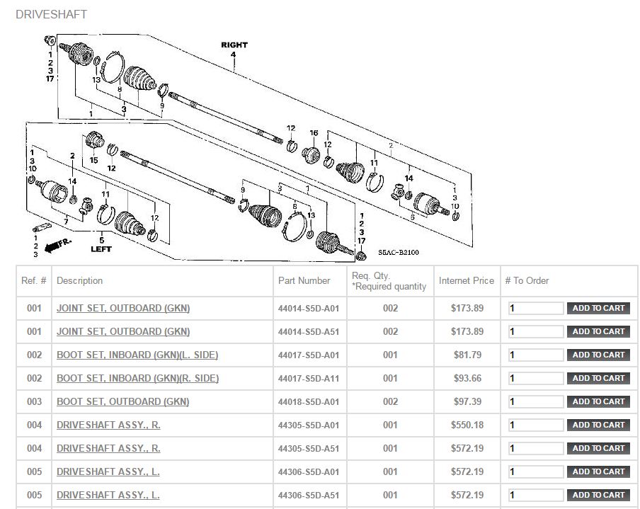

I checked torontohondaparts.com and there only seemed to be two options for axles, one for the DX, and one for the higher trim models, so maybe it has to do with abs?

Ok, thanks ezone, the site is supposed to supply OEM parts, I found it through one of the stickys on here.
The image is from selecting 05 civic 4 door with a manual trans, selecting an 05 2 door manual trans gives the same options.
So it seems like I'll be ok. Only one way to find out.
