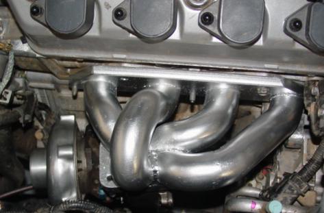

Here is a pic of the manifold
courtesy of SFpower and Catalyst
This is my car.

so fresh and soo clean ... nice job on the fabrication ... !
i'm interested .... please post the dyno sheets...!!

just to make an important note, if you put a turbo as big as the T-3 on a little engine like ours, there will be lag till around 3000-3500 rpm, ask some of the others on the site what theyre running, im sure theyll tell you theres a lot of lag. and look at the manifold, it may look clean but look at the primaries, theyre all different lengths, it doesnt look like they tried to make them similar, which is important for best performance. how much R&D time went into this system man?

Tell me, would you rather have a "Log style" Manifold? The primaries are all equal length, except for the #1 cylinder, which is only about 1/2 inche longer. And that was needed to keep the AC. Also, would you rather have much longer primaries? The longer it is, the less heat it has in the charge, which means slower spooling.
This manifold is made in such a way that the length of the primaries are as short, and as close to equal length as possible.
dont try to trash something that is nicer than the rest of the turbo kits youve ever seen for our cars.
After all, do you think Fiber Images would put a Piece of crap turbo kit on their car? Expecially after spending all that money on carbon fiber?
Think before you speak, and dont trash something based on a picture.

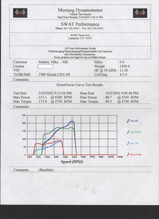

This kit is based on Staffords other kits, which make awesome street power. You want to see the dyno chart for my CRX with his kit on it? my crx went from 88 hp and 89 ft/lbs of torque (to the ground) to 215.1 hp and 176 ft/lbs to the ground.
Heres the numbers for my CRX, this was at 10 psi of boost
THIS IS NOT MY CIVIC, it is an 89 CRX HF

another thing to add, the T3 was not too big for my little 1.6L in my crx, which only had 88 hp to the ground. Since our civics have a 1.7L engine that makes more than 88 hp to the ground, you can probably expect some pretty good numbers from the new kit.
We will know as soon as my piping goes back on my car, so just wait until we have real numbers before you guys start trash talking again.

The thing that is wrong with a log style manifold is that the exhaust charges do not get to the turbo at the same time. Each cylinder's exhaust gas gets there in differing amounts of times, meaning that 2 cylinders can enter the turbo at the same time.
The log style manifolds are not Horrible, it is just that equal length manifolds give better spooling time, and they just look awesome.
