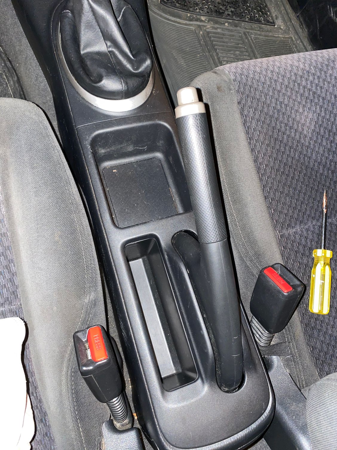

Hello I’m new to this forum. I recently bought a 2005 Honda Civic dx and I want to remove the center console as I am installing a shift boot and shift ****. I’ve already removed the trim clips at the front of the center console and I’ve removed the screws in the back but it still won’t come off. Any help would be appreciated

Does yours have the raised armrest around the e-brake or does it just have a little pocket deal with a sliding door?

mine actually doesn’t have either it looks like the sliding one without the sliding thing

ah, easy peasy then. Pull up the trim that surrounds the e-brake by using the hole the sliding door should be. I used to literally stick my hand in that hole (phrasing.. lol) and gently yank upwards to pop the clips. It should reveal 2 (or 4?) more screws you gotta remove to take out the shifter trim.

From what I see there isn’t any separation between the top park of the e brake trim and the storage compartment beside it

oh that's weird. I've never seen one without the sliding door over the rear pocket. Nevertheless, that plastic that surrounds the e-brake and has both of the pockets needs to come off.

There's screws on the side hidden by the seats

yes I removed those

How about the 4 below the rectangular plastic where the shifter is?

That's why I was saying the plastic around the e-brake with the 2 pockets need to come out

Yeah there should be screws underneath the bottom of those pockets

there isn’t. Just waiting to get some trim removal tools so that I don’t damage the plastic then I’ll try to pry off the e brake cover.
