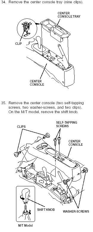

Its in an 02 EX 5 speed. anybody got a DIY on this?

Remove the 2 screws in the back (push front seats forward). Pull up on e-brake trim... snaps off. Undo 2 screws behind the shifter panel that are revealed when the Ebrake trim is removed, put a screwdriver in the center of the 2 poppers in the front (1 in each footwell).... push down on shift boot, unscrew ****, and lift up.

I did a screen print/cut and paste on the fog lights install pdf, which shows a diagram of removing the console. Hope this helps.

thanks for the info...thats a great pic. 16 cubic foot box and 4 amps going in for testing tomorrow tonite ill be rolling with no seat and no center console (gotta take it out to get the box in
