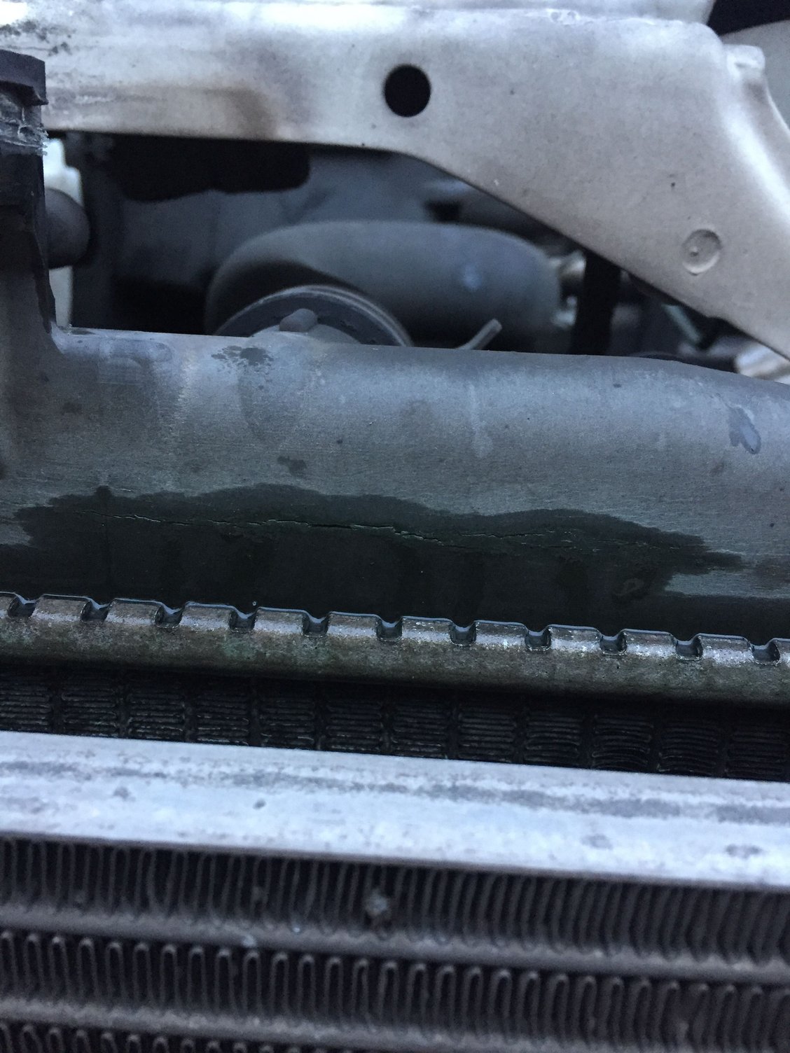

I decided to replace the radiator and I found this crack on the old on. I am glad that I replaced it. I pressure tested the system with the new radiator and it was good.
Thank you all for your help.

Glad you figured out the problem
