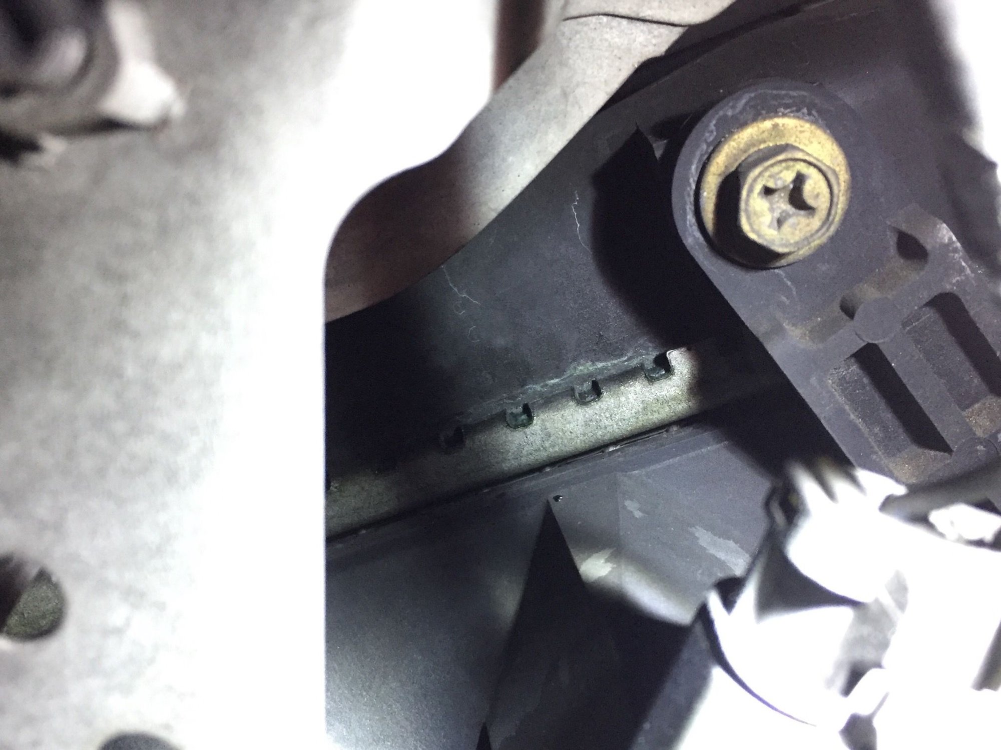

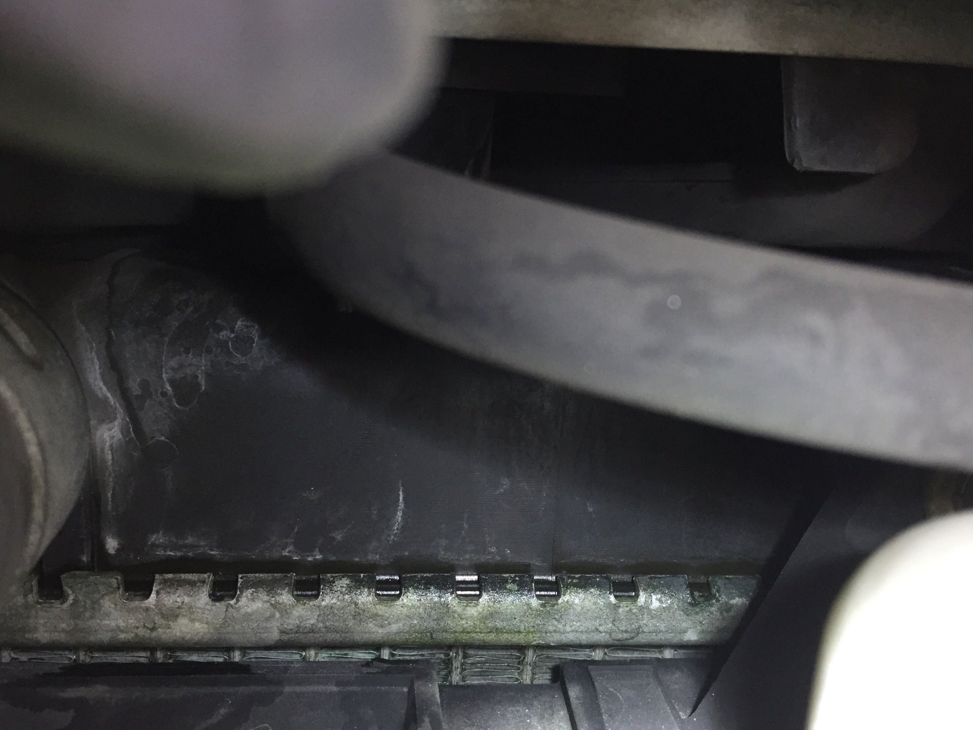

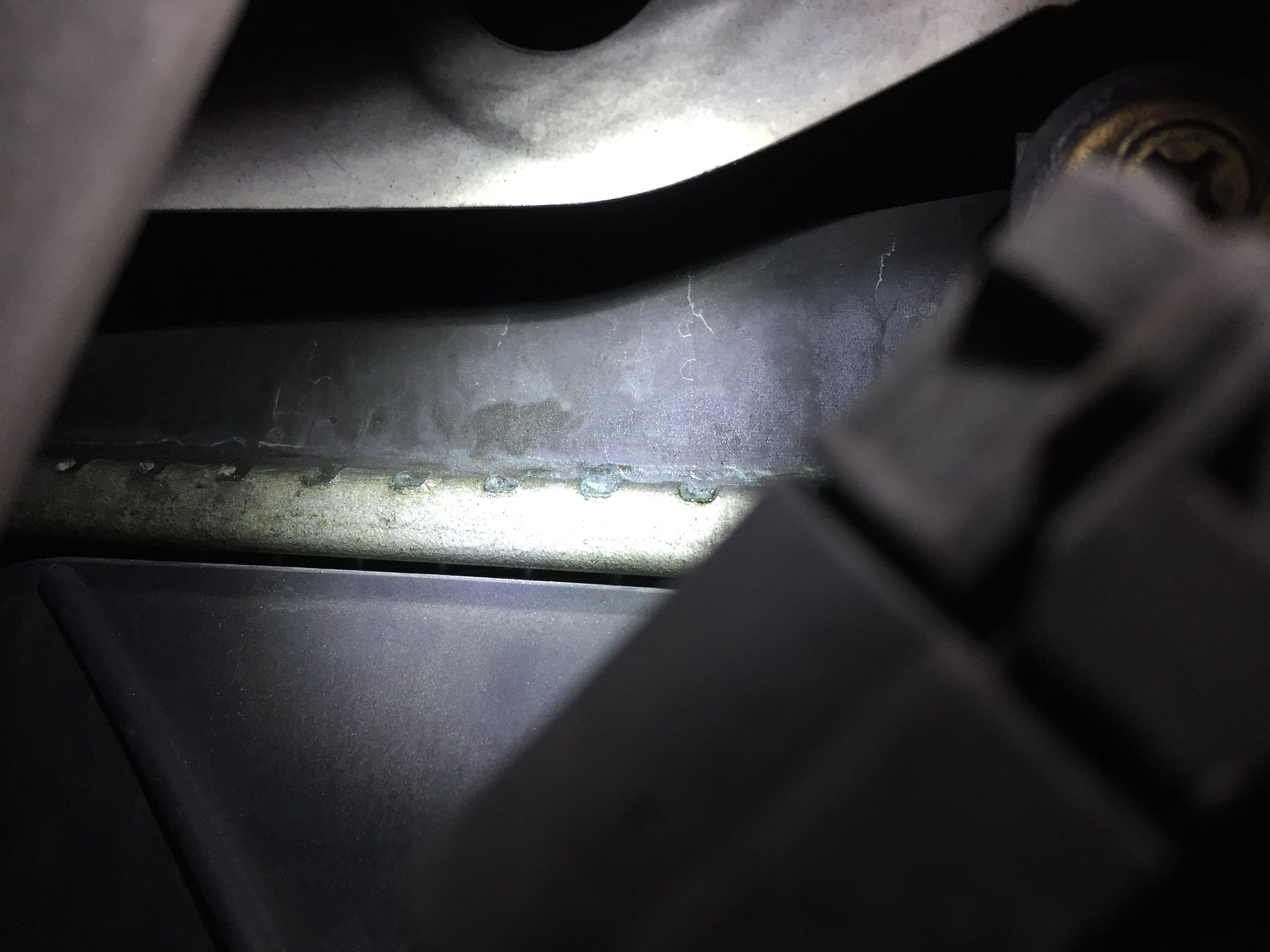

so, I couldn't find where the leak is... I think that the residue I found under the reservoir area is old oil from a leak that the valve cover had (I fixed it two years ago). I did not notice any leak coming from the hoses or the bottom of the radiator. I did notice that on one side fo the top of the radiator there was some deposit of green stuff similar to limescale from showerheads. What do you think? should I get the system tested? Now I remember over a year ago the coolant was pretty low; I filled it up and since I could not find any leaks I left it as that and I forgot about it. I wonder if the car has been leaking just a tiny bit and it reached a low level (I don't remember the last time I checked the water level...)

can you attach a picture of that stuff?
it's probably leaking there, they tend to develop pinholes at the seams
new rads are pretty cheap, denso is the oem brand

Pics

I can not attach the pic. I’ll wait until after work

that works

You can see in the last pic how wet that area is, and that antifreeze is not from filling up the radiator yesterday. I’ll keep an eye and report back. Thanks all for your hel and please keep posting suggestions and comments if you have them.

Pics: You will have to figure out if there's a slow but active leak there or if that's just residue leftover from whenever the radiator cap had been removed and liquid spilled.
Edit: Pressure test would show if the plastic tank is cracked....so might filling it and watching it.

That looks like it's leaking,
however it would be a good idea to test it for leaks to make sure
