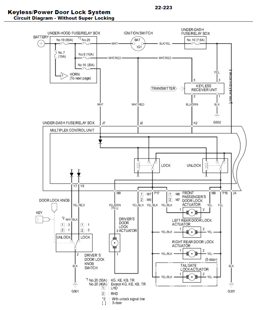

With everything you've done, I think it's safe to say this isn't an issue with the fobs or the receiver. I would use a meter to check the receiver wiring. If that checks out, I would start looking at the multiplex control unit (part of the under-dash fuse box). Here's the wiring diagram for the receiver. Definitely double check fuse 9 (10A) in the under-hood fuse box and fuse 10 (7.5A) in the under-dash fuse box.
