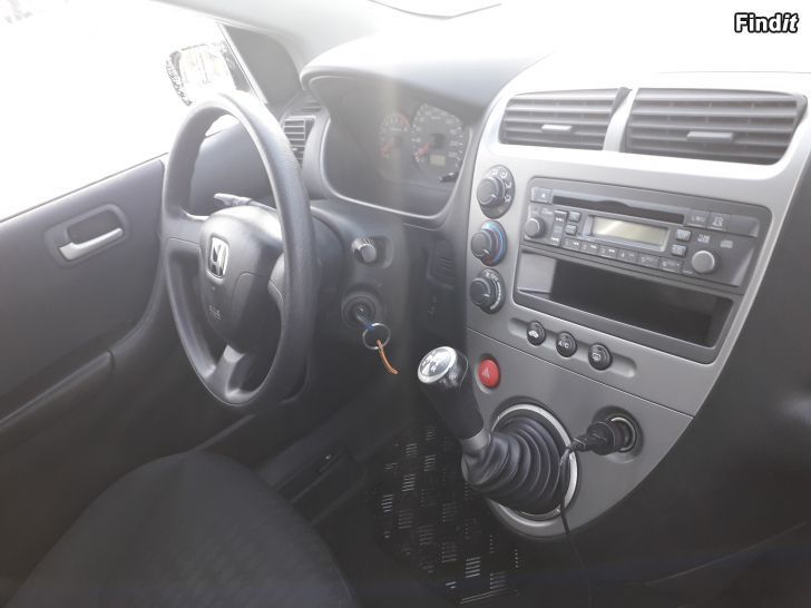

If anyone is up for giving a helping hand that would be much appreciated. I can take picture of any part of the dashboard if needed but here is a general view both outside and in for identification purposes.

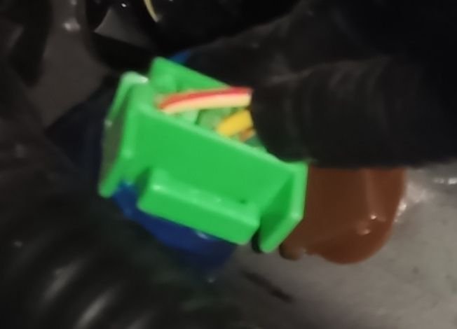

The module I am wondering if is compatible with my car
Inside view
Outside view for identification

US non-hatch cars have them at the door lever, don't see it in your interior pic.

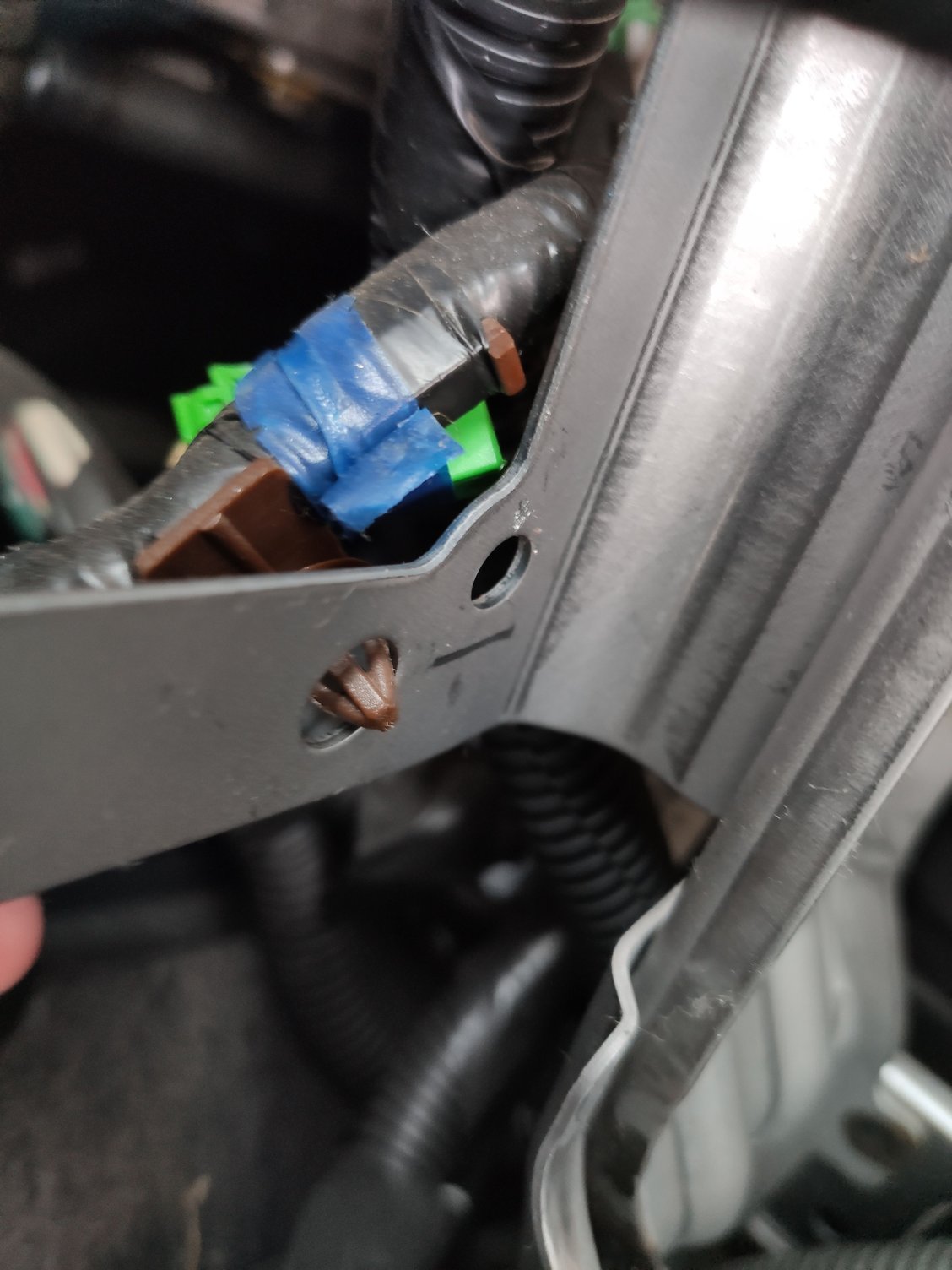

EDIT: I removed the dashboard lower console but there was nothing "behind the cigarette lighter" which some have indicated in posts online.
I also tried to get a better view by going through the glove box, but didn't see anything that stands out there either. Here is another image dump:
https://imgur.com/a/XFTsTM3
Since I cannot locate the wiring harness/connector for the module, I think it is safe to assume there most likely isn't one.
...but if I get a module off eBay with the connector and loose wires attached to it...the question is...will it work assuming I connect it correctly?
And the bigger question...where to connect it. Afaik there are three wires coming from the powerlock window button on the driver's side door. Four on the module.
​​​​​​​Would it perhaps be feasible to connect the module there?

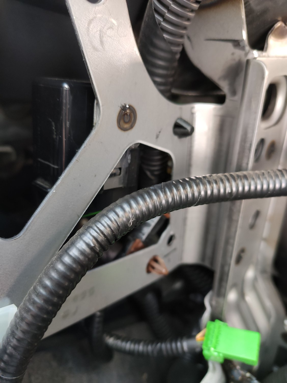

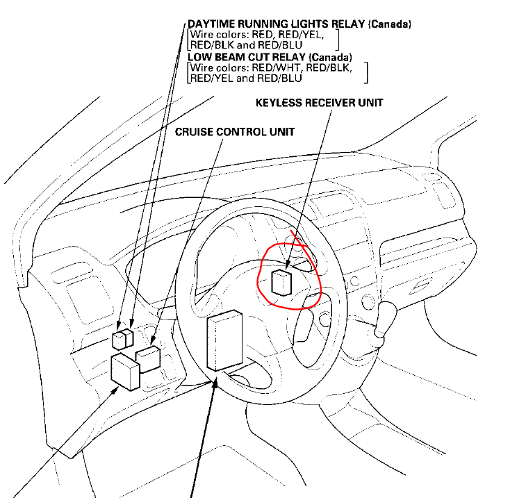

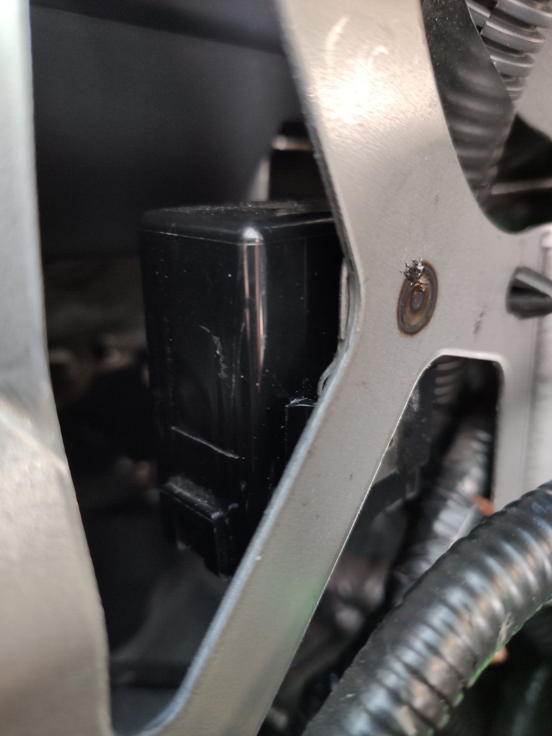

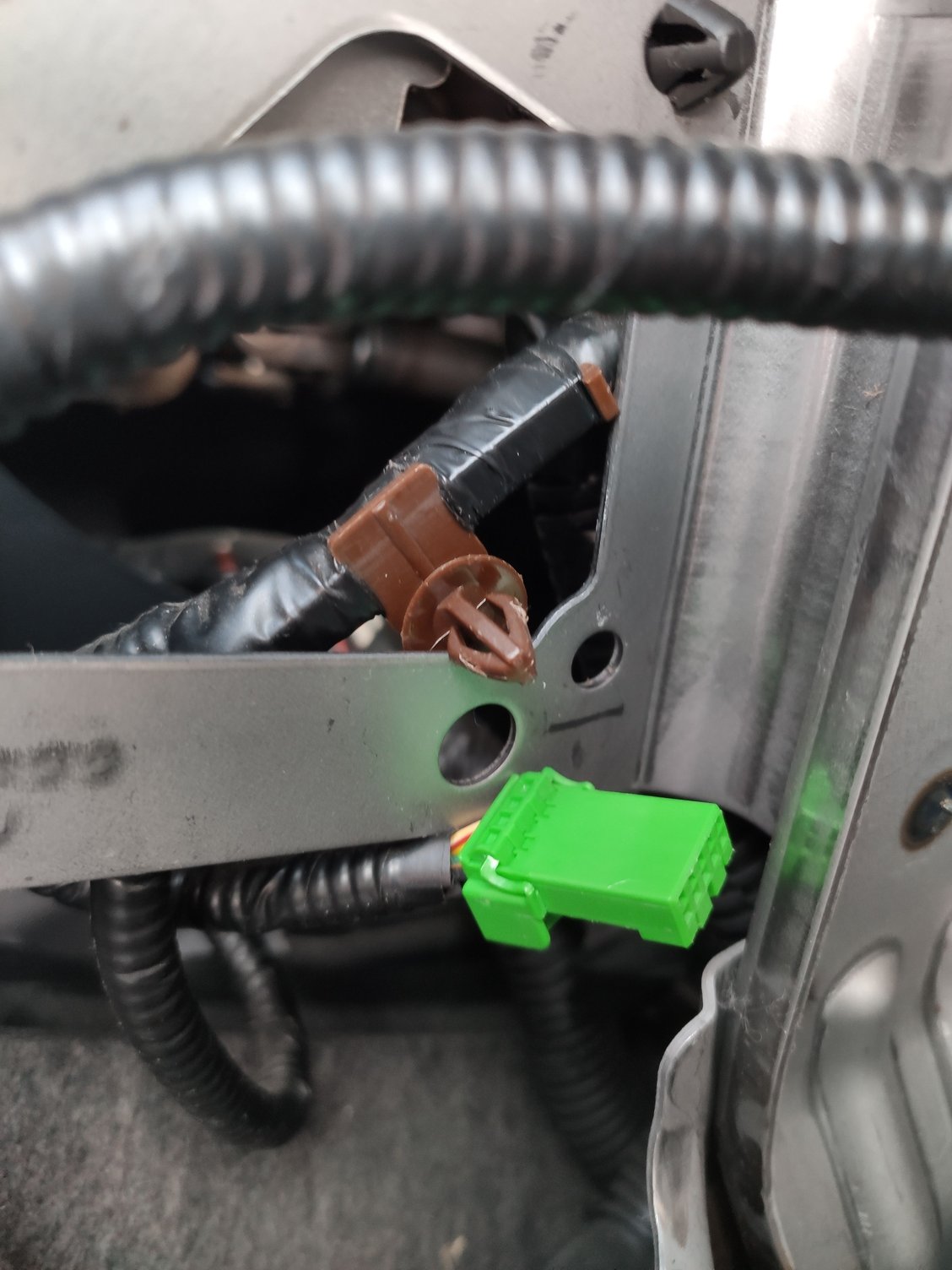

After some more internet sleuthing I think I FINALLY located the exact location of the module/connector. The diagram above is correct, as is the image in this CR-V instruction:
Link
It is located between the steering wheel and the center panel. I am in no condition to start checking, but I am hopeful the center pocket will be removable on my model car as well, and allow me easy access.
Here is a video, which at 3:06 shows the black module in the triangular opening in the frame. Hopefully mine will be there too. Or the connector at least.

Well, I was going a bit cabin-crazy sitting indoors and thinking about the missing cable/connector and it stopped snowing, so I dragged my sick self out to the car. The dashboard pocket seemed to not allow access so instead I opened the access to the fusebox and snapped some blind shots by sticking the camera in and using a series of shots in the approximate direction while panning.
After a few attempts...I think I see the connector! It exists! At least it sure looks like the right one.
Here is one photo of what it looks like, and one photo of what I found. You be the judge.
What it looks like
What I found
Old Apr 7, 2022
Colin42's Avatar
Posts: 9,641
Likes: 1,283
From: Barrie, ON Canada
Rep Power: 222
Re: Driver side lock almost broken - Keyless entry an option?
Looks like it to me

Another update on my epic journey to be able to unlock my frikkin car...
So...
I finally got the module after 2 MONTHS. I managed to remove the center console without too much problems (see images) and install the module.
After much wiggling...
There it is, finally
Blue tape removed...
Seated....
And connector installed
I manages to bind the keyfobs...
And every door except the driver side door now has keyless entry. All other doors open. And the driver side door was the only door that has problems.
So the question is...
Is the signal not getting to the driver side door? (Since the only way to open the driver side door was the key...is there even functionality for opening it?!)
Or is the signal not sent by the module? (Seems unlikely but just considering possibilities...)
Or are the keyfobs not sending the signal correctly? (Not OEM but identical-looking. Will ask others who have purchased them.)
Or is the driver side actuator broken? (Again, considering the key had to be physically used before...IS there even a driver side door lock actuator?!)
So 1 step forward, 1 step back. Seems likely I will have to open up the door at some point but I want to find out as much as possible as easily as possible before that so any comments ore ideas are much appreciated.
