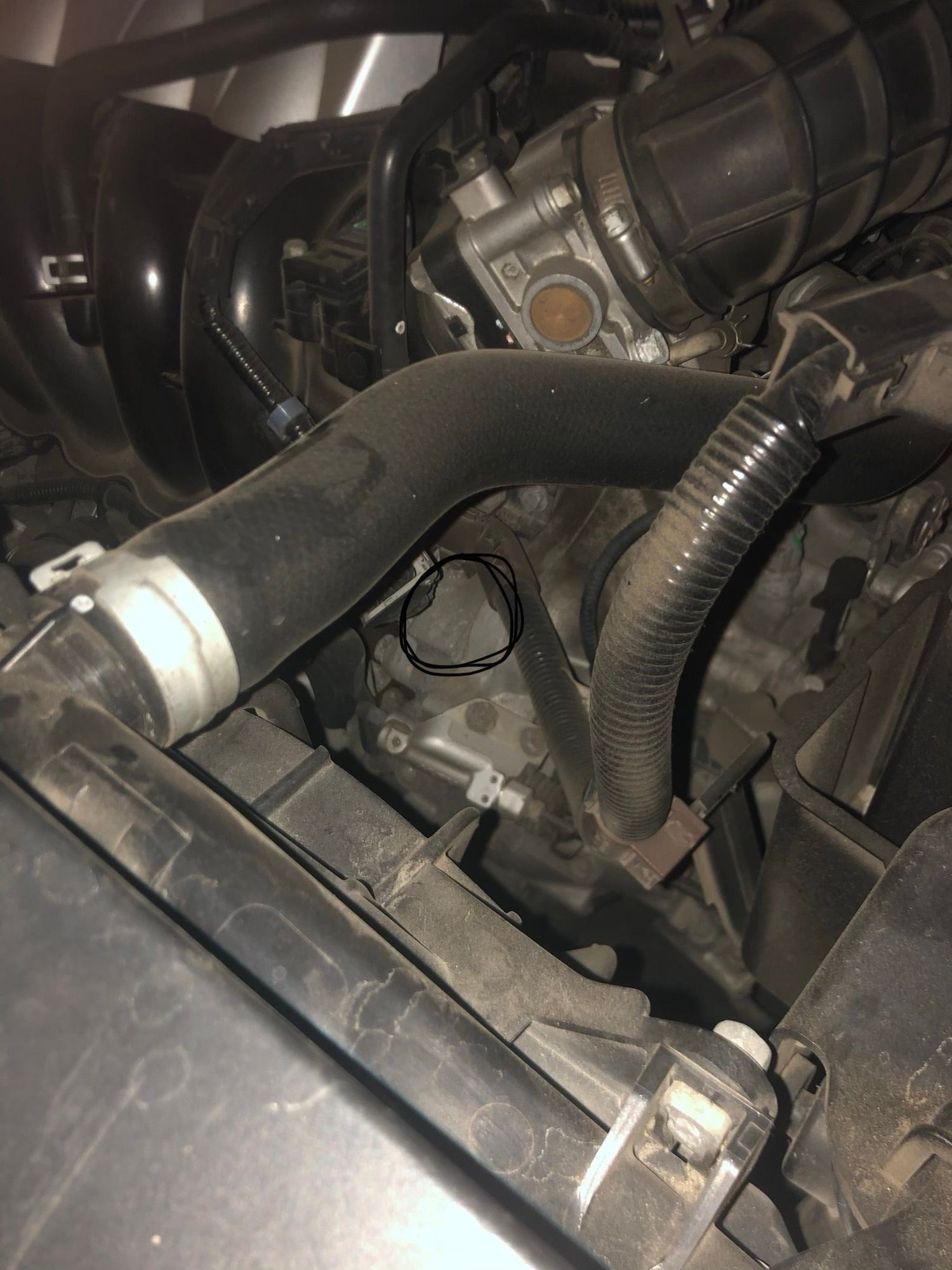

All fuses are good everything is plugged in to the ECU BUTTT I have two wires a black an white one an a red an yellow have no clue what they are for or where they go anyone got a idea?
We are going to be in the same boat. You'll have to trace the wires back and find where they originate.
