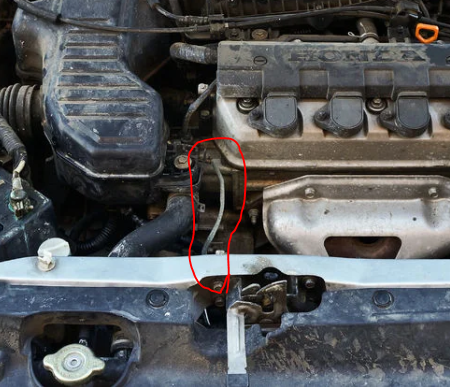

Got it going. G101 , t-stats housing ground. Thanks for the replies.

Originally Posted by James Roark
Where was that ground located??!?
It's literally two posts up...
Runs from the top of the thermostat housing to the radiator support.
